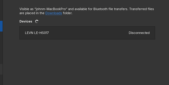

Background: MacBook Pro pre 2015 just installed Zorin 17 Pro.
This is a fresh install. I had it working but as soon as I rebooted it went away again. The funny thing is that after it comes online the spinny thing interrupts the wifi.

On reboot initially it is disconnected, but after reconnect is when I have the issue of it hitting the network and causing problems with the wifi.
