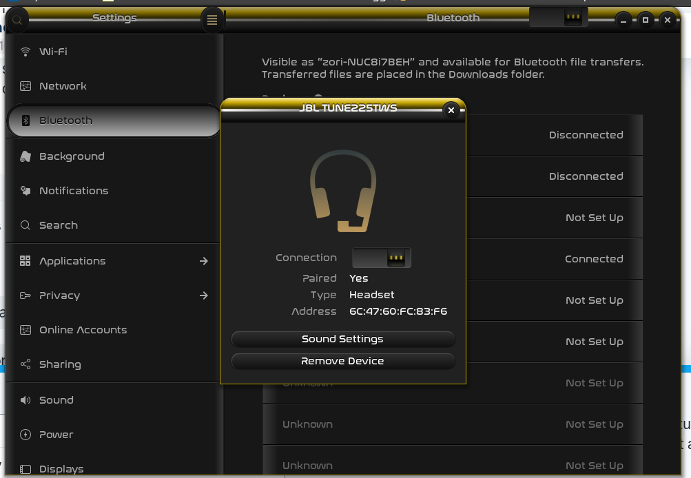

FrenchPress, sorry to crash the party but I'm using my JBL tune tws225 earphones right now. These use blueth. 5.0 and they connect and work perfect with Zorin16.
But I would like to ask hrishi if his speaker is also connected to other devices at the same time?
(I know that if I connect my JBL speakers to both pc and phone - at the same time - the one or other will not produce sound)
