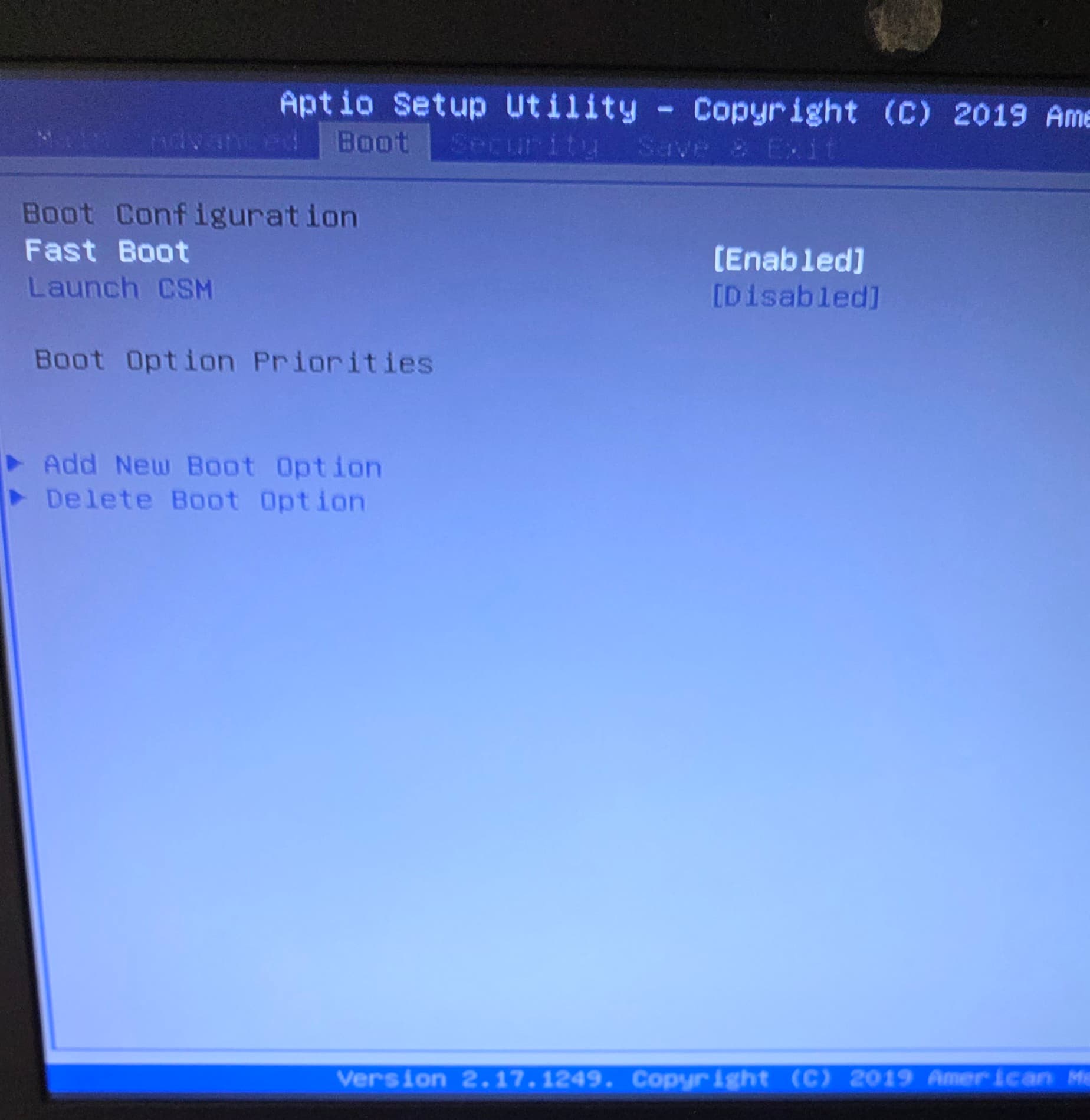

On Your Picture I see that Fast Boot is enabled. Turn it off. And check if Secure Boot is turned off, too.

I did what you said and the result is the same.

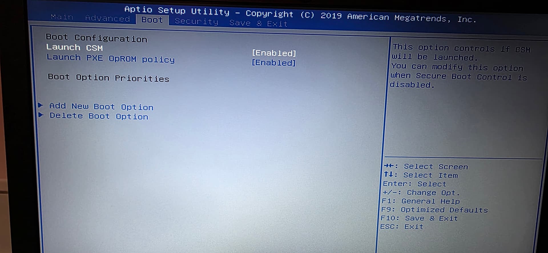

Try it with disabled CSM.
