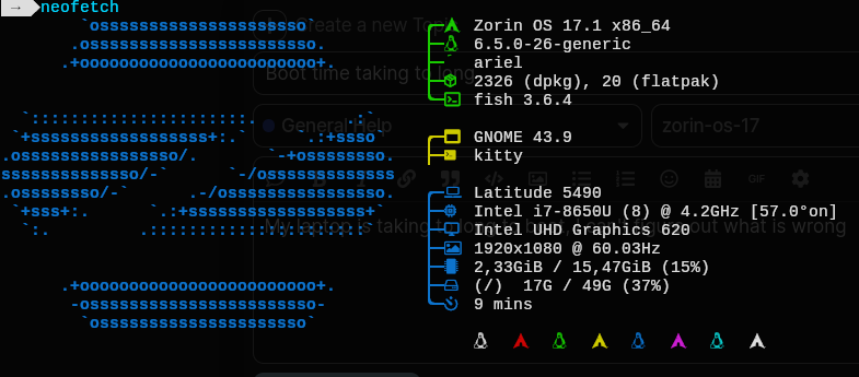

My laptop is taking to long to boot, I can't figure out what is wrong. This are my laptop's specs:

The laptop is a Dell Latitude 5490
