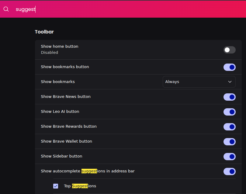

As you type in the address bar, you should see suggestions popping up as to what to search for. I don't know if Brave would try to resend the query if it fails the first time (for whatever reason) but this would explain the lag since every new keystroke would create a new loop of send, fail and retry.
Try disabling settings related to the Search, like telemetry and autocomplete suggestions. If you search in the settings for "suggest" you should see a bunch of related settings:
