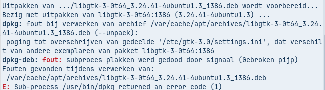

I'm using Zorin 18.1. When trying to install updates I get the message that an attempt to modify the shared '/etc/gtk-3.0/settings.ini' failed because it differs from other versions of the package libgtk-3-0t64. I the tries to install Timeshift but I get to same message. How can I resolve this?

Thanks. I tried both options, but I still get errors.

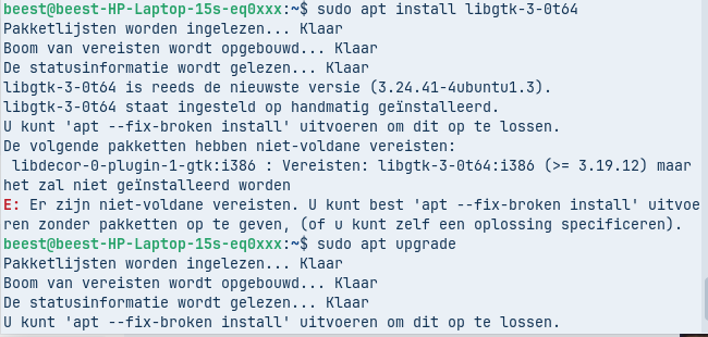

Now try your full system update:
sudo apt upgrade
Still not working. I get the message that the requirement is libgtk-3-0t64:i386 (>= 3.19.12) but that it will not be installed.
apt --fix-broken install doesn't help either.
