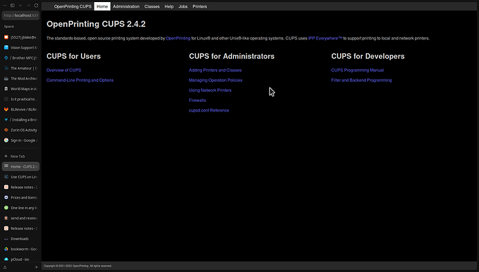

To check you may need to use CUPS via the browser:
localhost:631
Brings up this page in your browser:
