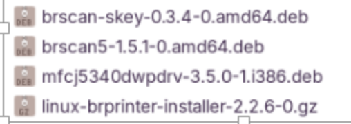

Driver Install Tool linux-brprinter-installer-2.2.6-0.gz, Linux Printer Driver mfcj5340dwpdrv-3.5.0-1.i386.deb, 3x Linux Scanner Drivers brscan5-1.5.1-0.amd64.deb + brscan-skey-0.3.4-0.amd64.deb + brother-udev-rule-type1-1.0.2-0.all.deb , Management Tool BrotherMassDeploymentTool_.NET_v2100100.tar.gz.

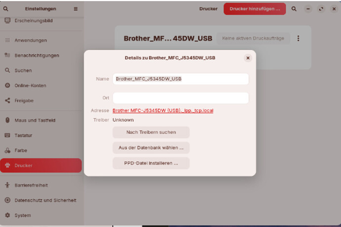

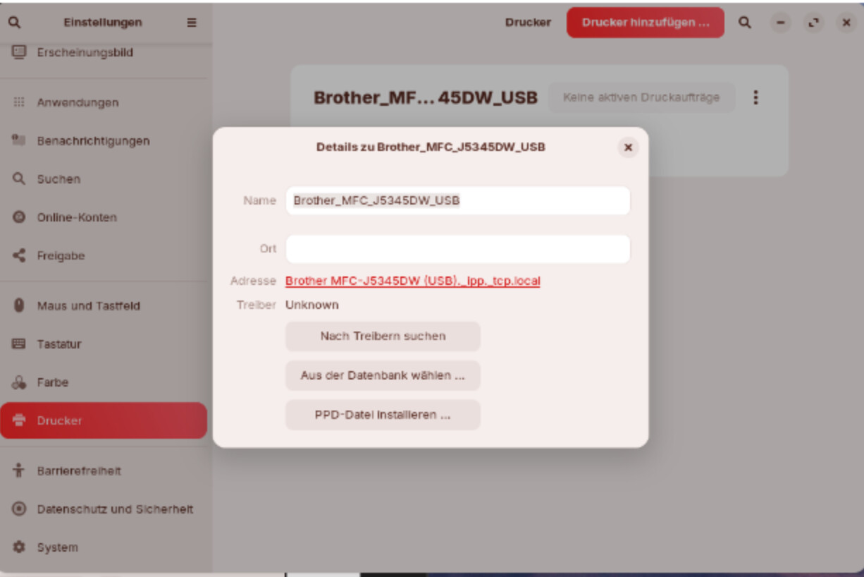

Dear swarfendor437, all together,
sorry for my late answer, printer Brother MFC-J5340DW arrived delayed.
Thanks for your amazing effort with the video tutorial even for my new printer model itself MFC-J5340DW . You had / made this printer available for the tutorial!!! Realy amazing!!!
Now I had the chance for Installation along your recommandations and your video tutorial:
  • Downloaded from brother support page for Germany for Linux (deb) Service & Support: Software Download & mehr | Brother
  • Printer connected via USB
  • gave the commands in Terminal as you recommanded:
    NUC:~$** sudo apt install system-config-printer
    NUC:~$** sudo apt install gdebi
    NUC:~$** sudo systemctl stop cups-browsed
    NUC:~$** sudo systemctl disable cups-browsed
    Removed "/etc/systemd/system/multi-user.target.wants/cups-browsed.service".

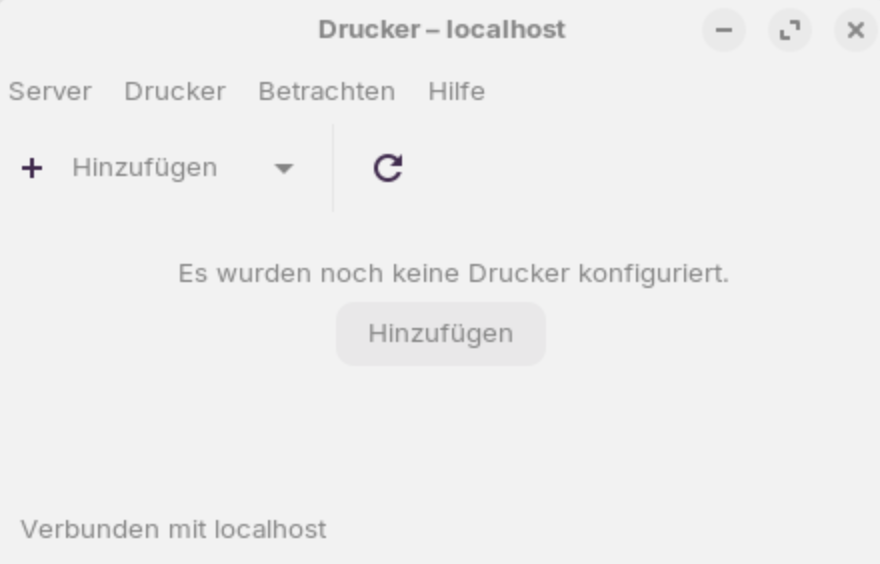

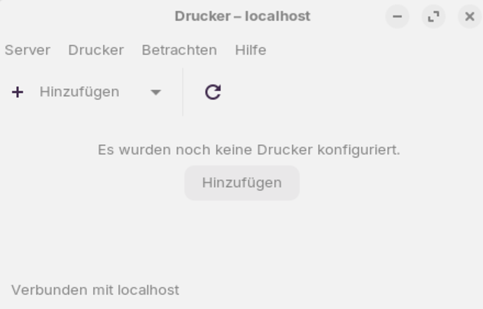

    NUC:~$** sudo system-config-printer
    -> the last command opened the printer window
Printer Drivers Install
the following 3 Drivers with GDEBI Package Installer:
  • mfcj5340dwpdrv-3.5.0-1.i386.deb
    -> after installing the printer appears within printer window
  • brscan5-1.5.1-0.amd64.deb
  • brscan-skey-0.3.4-0.amd64.deb

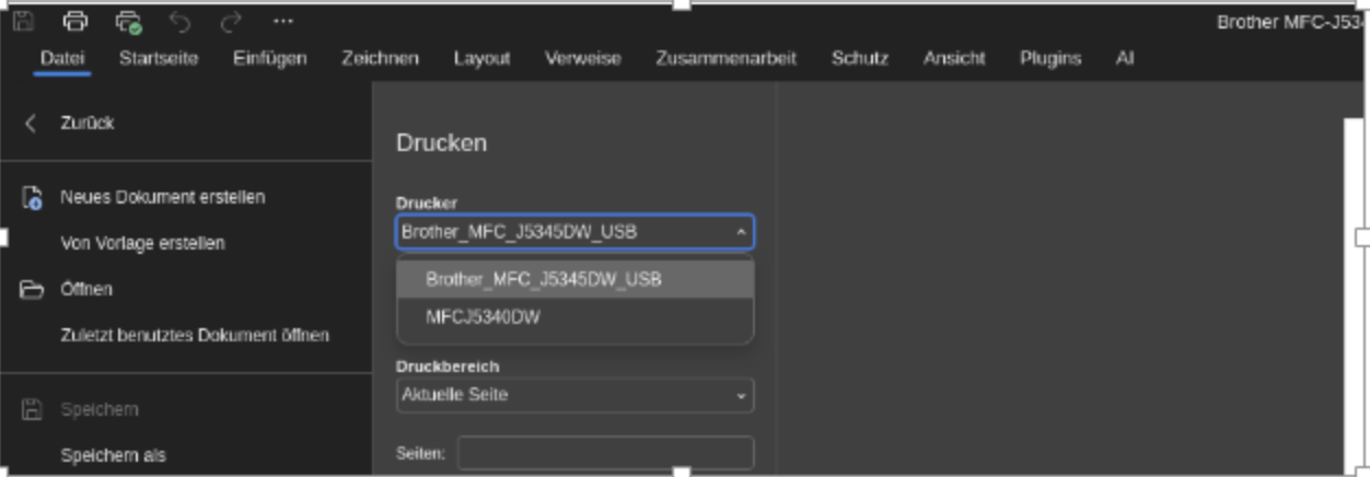

Afterwards printing jobs showed up in the queue but printing did not work. The printer window showed Message: "Waiting for printer to be available".
So, leaving the printer configuration as it is, I additonal unpacked and installed the linux-brprinter-installer-2.2.6-0.gz. During Installation I had to input the printer model: MFC-J5340DW, 3 package install verification: Y, the URI (printer Port /Address) and 2 times to confirm License agreements with: Y:
Begin of Installation with linux-brprinter-installer-2.2.6-0
NUC:~$** sudo bash linux-brprinter-installer-2.2.6-0
Input model name ->MFC-J5340DW
You are going to install following packages.
OK? [y/N] ->y

mfcj5340dwpdrv
Will you specify the Device URI? [Y/n] ->ipp://Brother%20MFC-J5345DW%20(USB)._ipp._tcp.local/
0: ipp
1: beh
2: https
3: ipps
4: socket
5: http
6: lpd
7: hp
8: hpfax
9: ipp://Brother%20MFC-J5345DW%20(USB)._ipp._tcp.local/
10 (I): Specify IP address.
11 (A): Auto. (usb://dev/usblp0)
select the number of destination Device URI. ->11
lpadmin -p MFCJ5340DW -v usb://dev/usblp0 -E
Test Print? [y/N] ->y
wait 5s.
lpr -P MFCJ5340DW /usr/share/cups/data/testprint

Despite the error messages afterwards I was able to print once:
But unfortunally after reboot printer not working again...
Tried to delete the Printers and reworked the whole Procedure from beginning to end, but was not able to get it working again. It did not create the USB printer again. May be I did not purge everything exactly before new printer install?
Do you have ideas for
  • deleting all rests of printer configuration
  • install the printer permanently
Many Thanks in advance! And hope that these infos help some of you to come further!
Hey, Thanks for the update.
Strange that you needed the brother driver tool. I helped another forum member install their brother printer remotely using Team Viewer and there were no issues.
About to take our pooch :dog: out on a walk. When you launch
click on add printer, then it launches the interface for Network/USB options.
Click on continue, then it should ak you to install driver. First window should pull up all different brands of printers. Obviously pick Brother and scroll down the list and see if the driver is listed (it should usually have something along the lines of 'recommended CUPS/Gutenprint driver'.
Additionally, check the properties of the printer, especially paper size, make sure it is not set to Letter as this will also prevent printer from printing.
