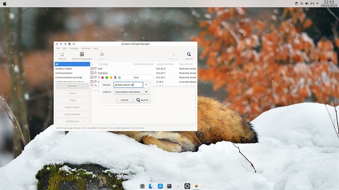

Just to do a belt and braces job, install Synaptic Package Manager from Software.
After that, launch it (you will be asked for your login password to elevate you to 'root' = administrator) and look for 'printer-driver-all':
