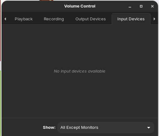

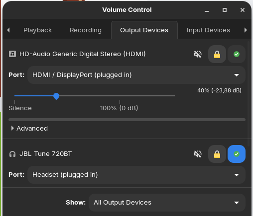

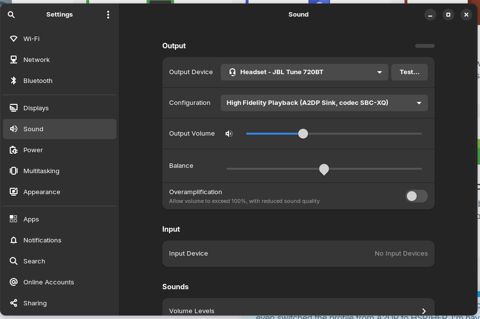

Hi, so i have the Problem that Zorin OS detects my Headphones (JBL Tune 720BT) Speakers, but not the Microphone.
This is really annoying, so can anyone help me with that?

Are you on Zorin 17 or 18?
What is the terminal output of
aplay -l && arecord -l
when your headset is connected?
If you are on 17, you could create a Zorin bootstick with Zorin 18 and boot from in "Try Zorin" mode to see if the headset microphone works there. At profile selectHSF/HFP.
If yes, you could consider to switch to Zorin 18 or install pipewire on Zorin 17.

im on 18, just freshly installed it on a new PC yesterday

wait, lmao
i fixxed it, by switching to Handsfree 720 BT in the settings which just appeared there as an option.
Now i hear background noise all the Time tho.
