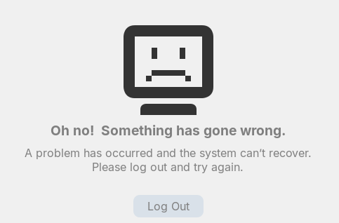

  1. GNOME Shell crashes and shows:
β€œA problem has occurred and the system can’t recover. Please log out and try again.”

:cross_mark: Actual Result
GNOME Shell crashes and GDM cannot recover the session.
