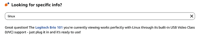

:wink:
I chose something pretty similar. Thanks for the suggestion.
