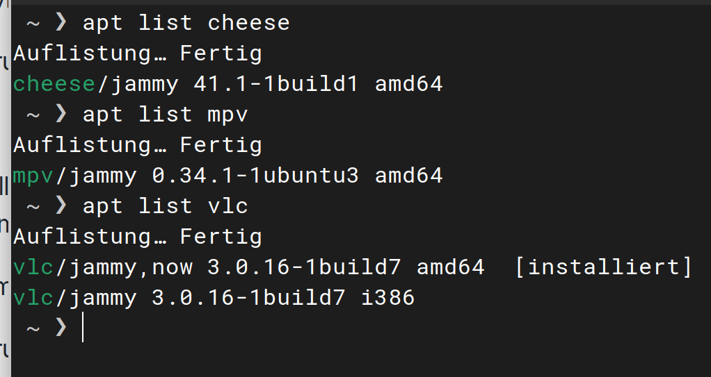

when you open the Terminal and type apt list and then the Package Name, do you get found Results? I checked it and found all 3 of them:

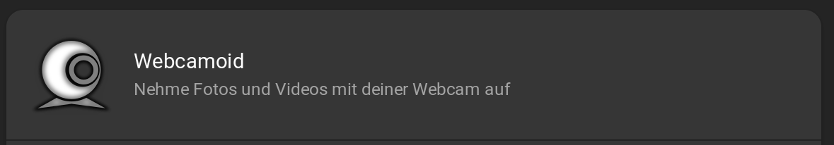

Hmm ... Okay, let's try this: I don't know if it is avialable in Zorin 16 but there is a Program called Webcamoid:

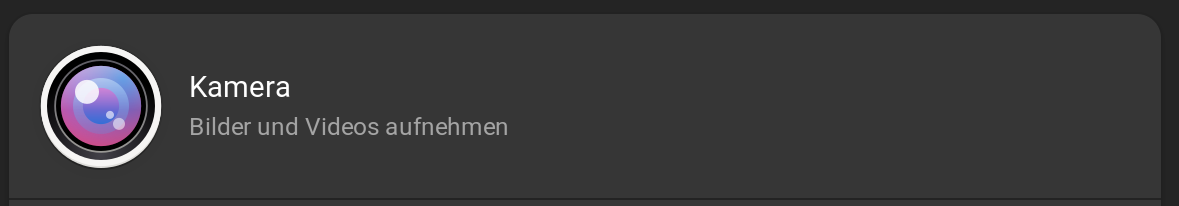

Another Option - if available - would be Snapshot:
(Don't be irritated by the Name; this is localized Gnome Naming)
Try these and check if one of this (or both) work.
