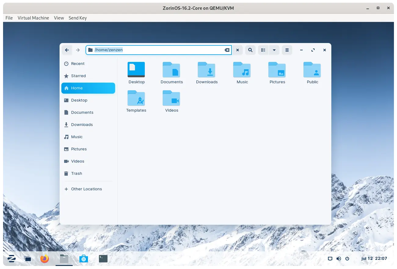

Once you boot from a bootable / live USB, similar to how you installed ZorinOS, you should be able to navigate to all the directories in the hard drive. You can learn how to do this following this guide:
Once you are in, open the file explorer and navigate to /home/<your_username>. You can type in directly in the address bar by pressing Ctrl + L.
Assuming the hard drive works normally, you should be able to see your files there. I suggest you copy them to an external hard drive or cloud service first and foremost. Once your files are safe you can proceed in one of two ways:
