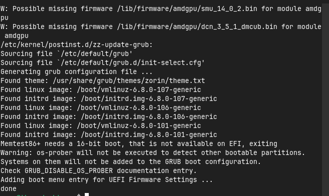

Can someone elaborate this?
Just updated my system, but found this on the terminal, i dont know if this is an update error or something else i can see its related to grub but how much it is.
The os-prober warning is normal because os-prober is disabled by default. To me it looks as a normal kernel update.
I don't know what the warnings in line 1 and 2 are.
I believe those errors are being caused by me using the integrated graphics, since i dont have a dedicated gpu.
This came after a Kernel Update? The missing Firmware can happen but is not directly a big Issue. The os-prober is a Program what runs to find other OS on the Machine to add then to GRUB. When You only have Zorin installed, it isn't active.
Please see this thread:
What Possible Missing Firmware means: It is a placeholder of expected firmware that is anticipated to be included in the kernel. These are pretty common with AMD, since the lists are generated before the inclusion of modules. Generally, it means keep an eye out for updates - But; if you are experiencing a need for the firmware immediately, you often can download and move it right away.
