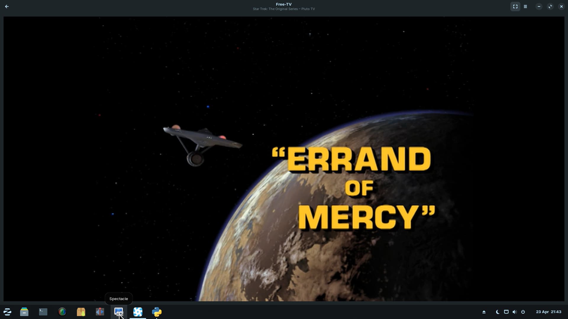

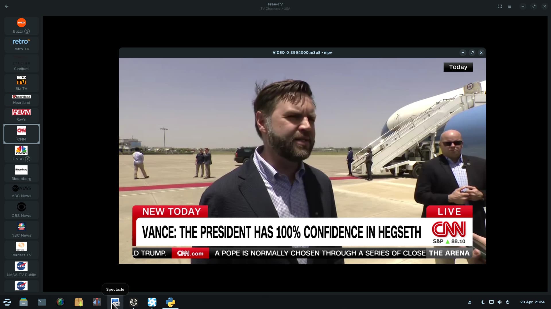

Just been playing around in Zorin 17 without Software present. On initial search I was drawn to a github page which indicated a snap package. I found a .deb package of hypnotix but was missing a dependency gir1.2-xapp-1.0 but the version was not high enough. Eventually found this:
Attempted to install the latest one but it came up with dependency error.
Went for version 2.0 all .deb file from the site above and have it working:
I used terminal command:
sudo apt install gdebi
then
gdebi-gtk
This brings up the interface, then File | Open - and point to the downloaded .deb file to install - you will be asked for your password to install the _all.deb package.
Original Star Trek in Italian (audio):
