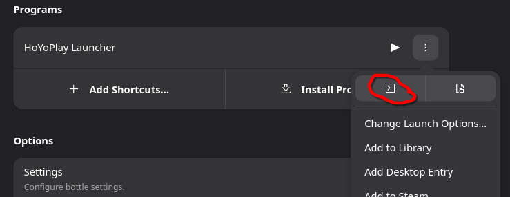

If you still have saves that can reproduce the problem, do this:
Launch the game with the circled button in my screenshot, then reproduce the issue. You'll have a terminal window in addition to the game window, with all of Proton's output. any errors shown there may help pin this down. Or may not, but it's worth a try.

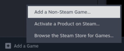

  3. In the lower left corner, click “Add a Game” and choose “Add a Non-Steam Game...”
  4. Browse and select the game’s .exe file from the location you placed it in

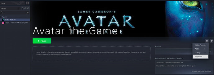

  5. Click on the game added to your library, and then click on the gear icon -> Properties

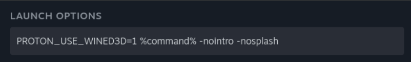

  6. Add the following launch options. This tells Proton to use wined3d (OpenGL backend) instead of DXVK (Vulkan backend) - I did this because I had issues with Vulkan.
    PROTON_USE_WINED3D=1 %command% -nointro -nosplash

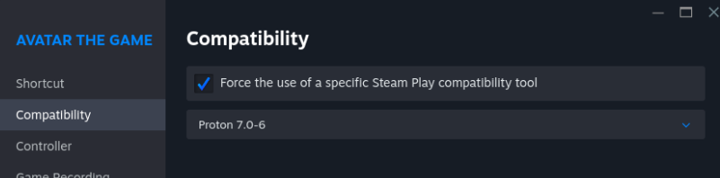

  7. Force a specific compatibility tool – Proton 7.0-6
And then just run the game, and voila! :sparkles:
