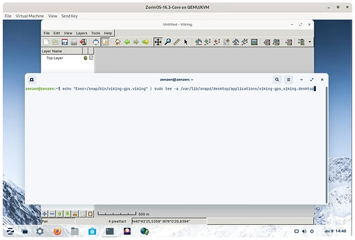

Here's one easy way to fix this problem for this particular software and version... and yes, it involves using the teeeerrrmiiinalll :ghost:
echo "Exec=/snap/bin/viking-gps.viking" | sudo tee -a /var/lib/snapd/desktop/applications/viking-gps_viking.desktop
You will be prompted for your password, but after that it should launch:

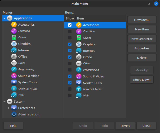

For your 'start menu' entries - open the Menu Editor, in the left column, you should see 'Wine' in the list - in that list will be your launchers for Wine apps. You may need to logout / login or reboot to see changes, but you can check the ones you want to show in your 'start menu', or uncheck the ones you don't want.

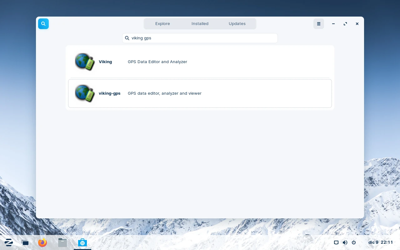

Anyway, I just took another look at turns out that someone has done a very lousy job at naming their package (another bug report for the developers...)

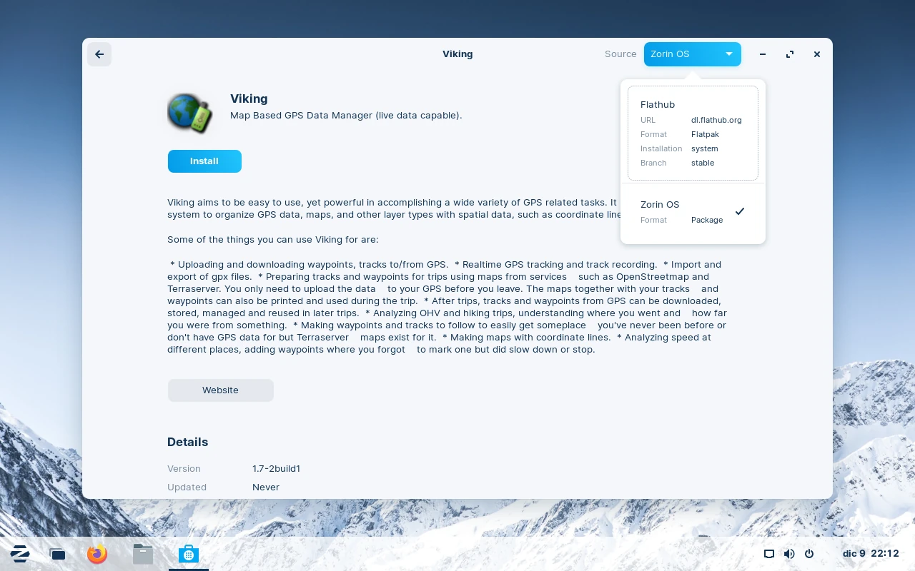

First, remove the current installation. Make sure you select the first option, named "Viking". Then, on the top-right corner you will see a drop-down where you can choose between Flatpak and ZorinOS; I would suggest using the latter option, as that is the native format used in Debian- and Ubuntu-based distributions, such as ZorinOS.
Install that, and see if it runs normally.

Also worth mentioning that I did have the same error message when I blindly install the first package that I saw, which was a snap. The second method I outlined above using the .deb package runs without any further action.

For troubleshooting the existing install, refer to what others said above: remove existing installations, and preferably install the versions available from the Software Store. In most cases Flathub is your friend
(as in, the preferred source to use in the Software Center, see the dropdown outlined in screenshots above)

Wine folder is there. Regarding 'menu editor,' I see know such option, but when I searched for the term, software wants to install it?! Still feelin' like something went bad on the install...

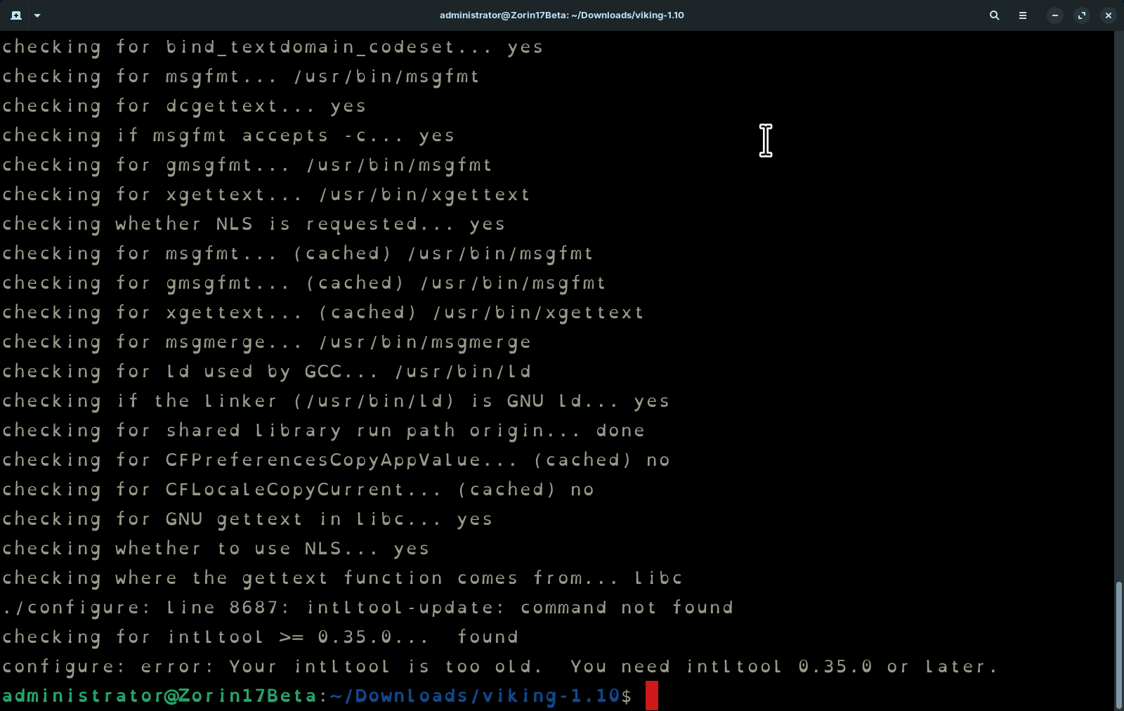

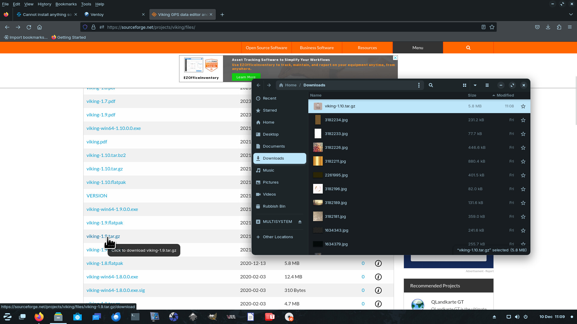

Couldn't find a .deb package on sourceforge unless it is wrapped in the .tar.gz.
I extracted the tarball and followed the advice on installation to open a terminal and enter:
./configure
I then get an out of date pkg notification:

I removed the old app, chose the option zenzen suggested, and chose Zorin OS as the source. Looks like that worked.

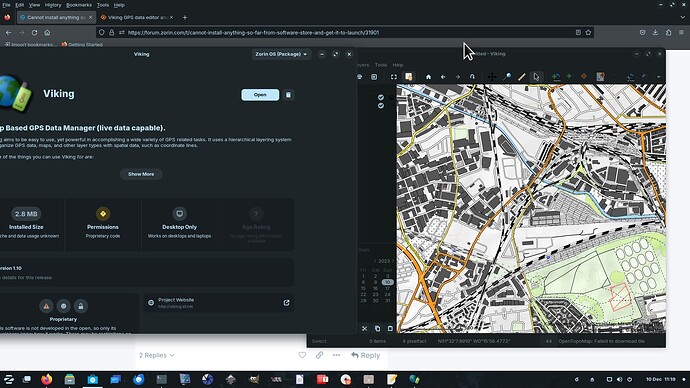

Installed from the Store on 17 Beta without any issues:

In your main apps menu, should be in alphabetical order, or just search 'menu' and it should pop up. I'm in Mint but, is the same utility:
Might be in a different category than where it would be expected - like if my Firefox were under System Tools. It's not - just as an example..
Yep. Finally got Viking to install/work based on recommendations above, and it finally showed up under 'Science.' I'm OK with that, at least I can "see"/find it now where there was nothing before, thx. Consequently, maybe I don;t need wine now that Viking installed/works, but, not afraid of learnin'.

(on Z17) this is also available when right-clicking the Zorin Menu button and hitting "Edit Menu"
