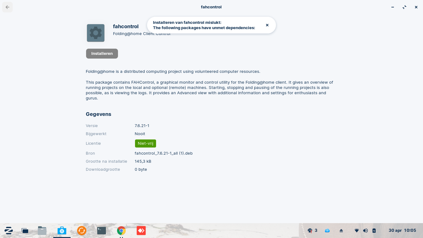

Cannot install Folding At Home control in Zorin 16
Zorin did install the client and the viewer of Folding at Home but refuses to install the conroll ( Debian file, collected on the F@H site-twice)
There are files missing but I have NO clue how to proceed from here.
If I use the webcontrol I see that the client is running, but I like it to have local as well.
Who can help?

The install gives that the package has unmet dependicies , but I have no clue which ones and where to see that notation

Are you able to screenshot the screen showing the dependencies error? Or does it only relay that dependencies are missing, with no other information?
