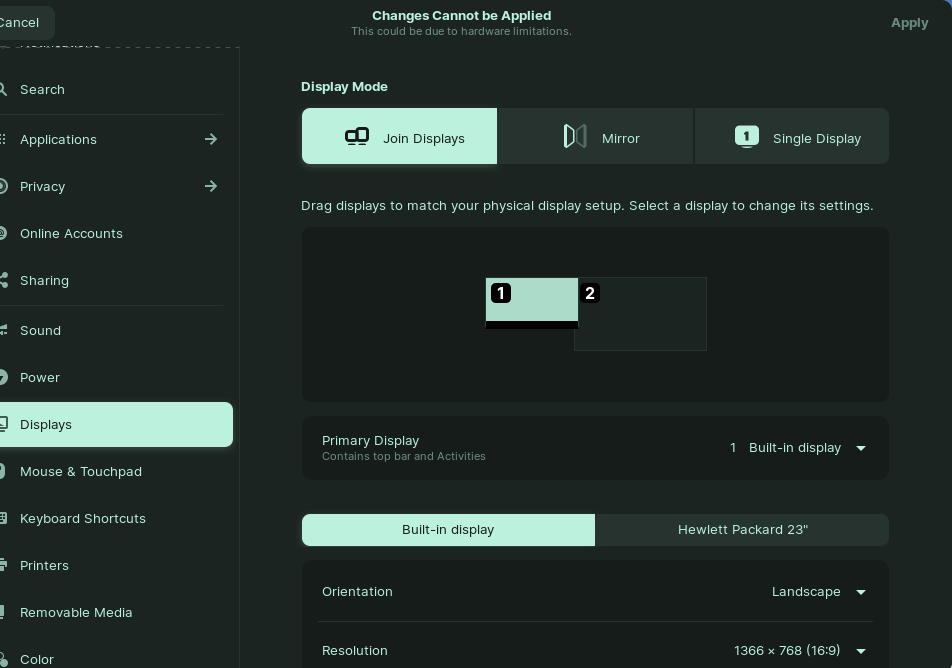

Working with zorin 16 and just connected an external monitor, apparently i can only mirror the displays but cannot "join" them. Am receiving the error that joining the screen "is not possible" due to hardware limitations. Am connecting via HDMI cable.
Any help is much appreciated. Have also attached a copy of the display settings screen.

I just was looking over some rather long standing bug reports for Gnome Control Center and I can see that the error message you get:
Changes cannot be applied, this could be due to hardware limitation may be a Settings app (Gnome control center) issue.
You can verify this using a LiveUSB of Zorin OS Lite to see if you have the same issue on it or not.
