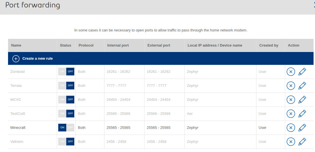

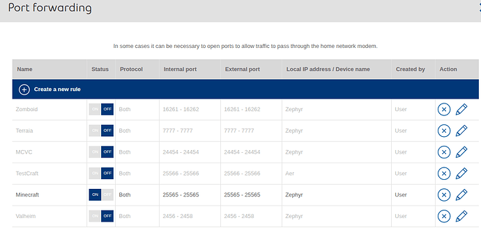

What does your port forwarding rule on your router look like?
To answer both questions 2 and 3, Zorin PC (Zephyr) is 192.168.100.101. My Windows PC (Aer) is 192.168.100.102. My router/modem is ISP provided. I've tried many combos on Windows to connect to the Zorin server, publicIP, publicIP:port, localIP, localIP:port. Nothing really worked.

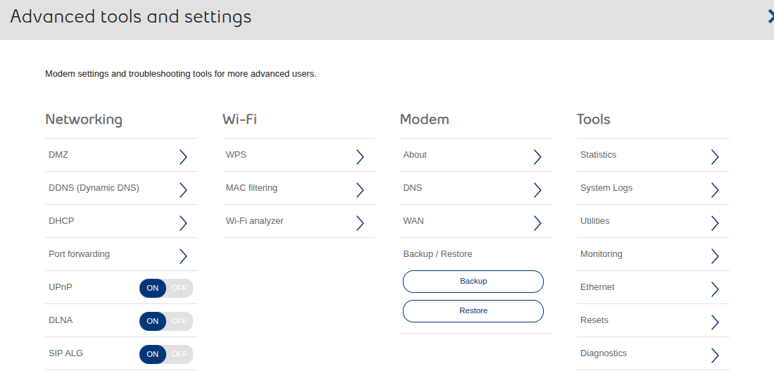

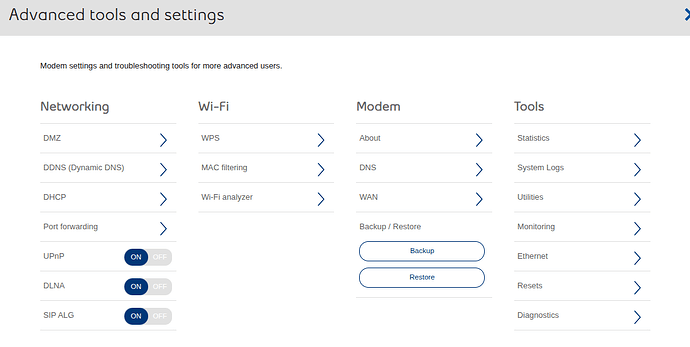

For my port forwarding, I can manually enter a local IP, but if it matches a recognised device, it will automatically show the device name. Because I can't have duplicate ports for different devices, I've had to switch the local IP/device back and forth between PCs, so forgetting to switch to Zorin from Windows while testing isn't the issue.
Here's my settings. DMZ: off, DDNS: off, DHCP: on (I believe this was done by the installer, and it looks like it sets up the last two numbers of the subnet and sets up the IP range). Not quite sure what else would contribute, but regardless same settings that I know of, still works on Windows.
Hmm ok. That's definitely a bit of a stumper, because all those seem to be what they should be doing. I do know that recently Zorin was having a lot of issues with connections, especially in the SMB territory, but I'm wondering if something else may have happened (or is in the same vein) that is stopping this from functioning properly as well.

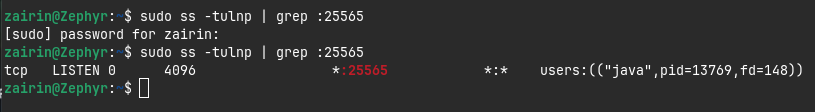

Could you try running this command to see if anything else is using the port ?
sudo ss -tulnp | grep :25565
No worries, I appreciate the help from everyone. I don't mind if it takes a while (given the topic doesn't close eventually), I'm mostly just worried about getting it fixed.
First command is without the server running. Second is with it running. Doesn't seem as if something else is using the port.
