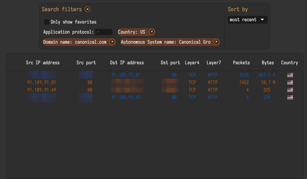

I just opened a network monitoring tool in my zoris os 16.3 core and then i saw Canonical continuosly collecting data. By seeing that restarted my computer but still its collecting data.

Canonical does collect mundane information such as computer specs, whether live patch is enabled and so on. No personal data or personal identifiers.
You can check and manage transparency with the terminal command
ubuntu-report
to see the data.
You can fully Opt Out.
ubuntu-report -f send no
