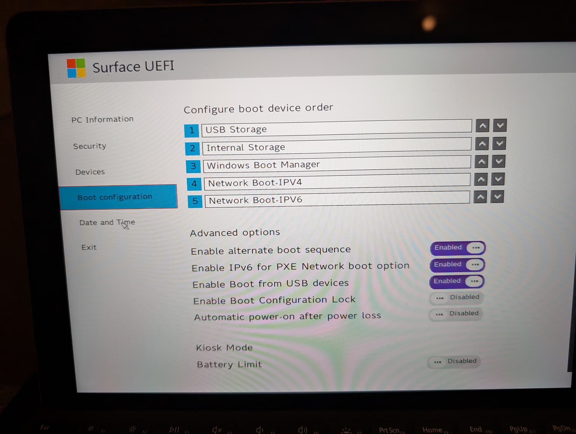

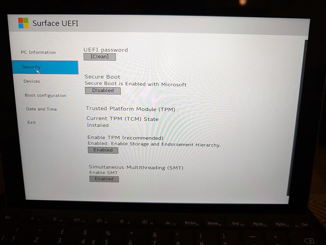

I have attached photos of the security section and the boot configuration for Surface UEFI.
Okay, can You click on the ''USB Storage'' Entry in Picture 2 to start it? or navigate with the Arrow Keys to it and press Enter?
The Secure Boot irritates me a bit. There stands ''Secure Boot is Enabled with Microsoft'' and under it stands ''Disabled''

I see you have "Boot from USB devices" active.

I noticed on your UEFI/Security screenshot, TPM set as Enabled.
I am aware Secure Boot should be Disabled but I also wonder if that is worth looking at changing TPM to Disabled if only Linux (not Windows) will be used.
