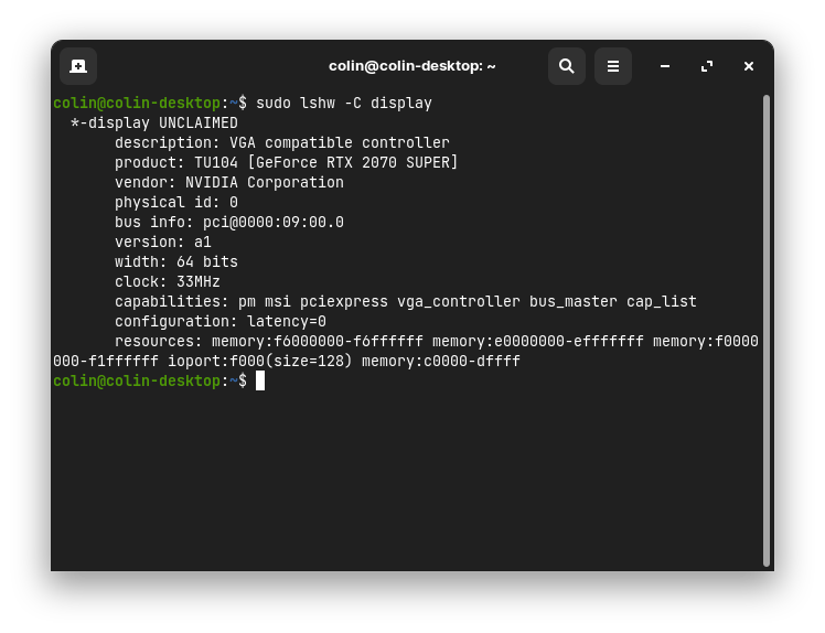

With all monitors connected that you are using, please run this command in terminal.
CTRL ALT T to bring up terminal
sudo lshw -C display

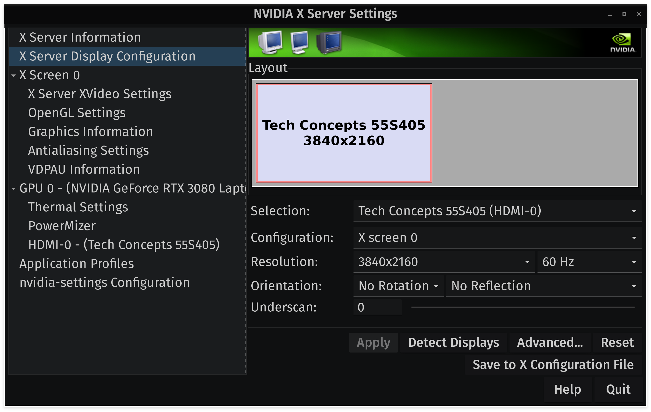

I also assume you have checked your Nvidia Xserver Settings?
