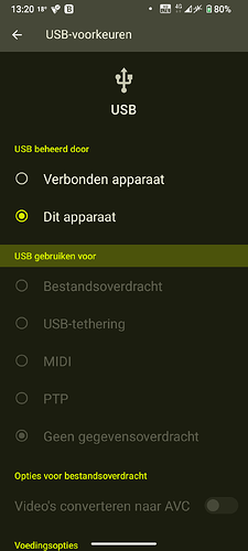

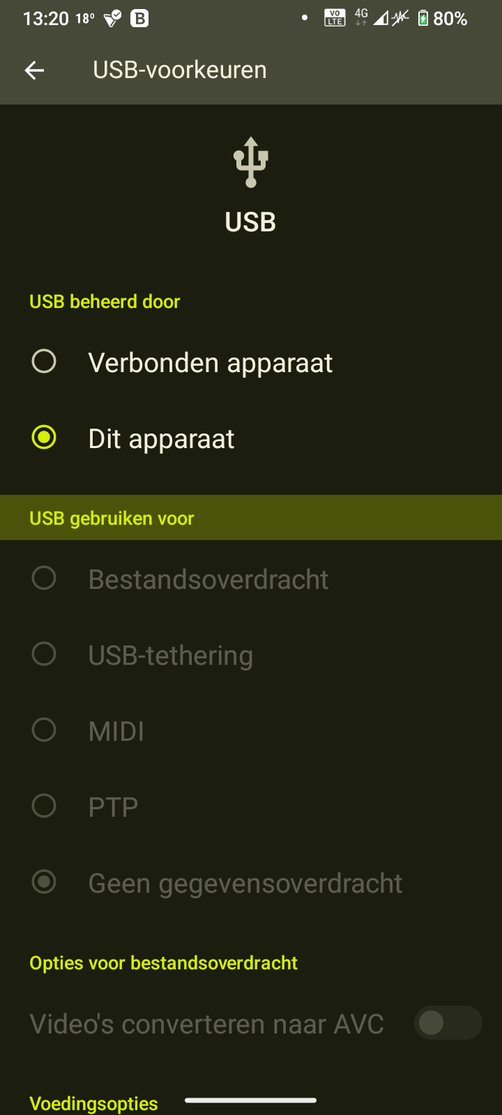

On my phone display the usb options, like file transfer , tethering etc do not light up.

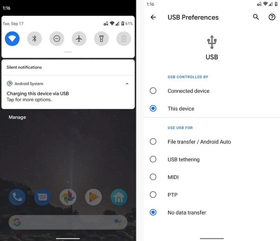

If I plug my phone into my computer using the USB port, the phone itself asks the method in which I want to connect. Make sure you are choosing the right method with your phone, and that you haven't disabled USB usage on your phone.
This picture from the net...
Depending on your mobile device, turn on Dev options and turn on USB debugging
This may help,

When I plug my phone to a usb port, nothing happens. See ss
There is no detection whatsoever. Same goes for my external drive which should be ready for Linux. Bought is especially for that reason.

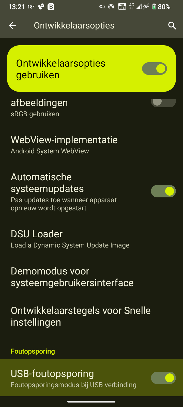

Yes. i turned on the developers function and usb debug. But again nothing happens.

so with usb debugging on now, when you plug it in to your laptop is there any notification such as a charging notification something should pop up when you pull down from the top giving you more options,
you may also need to enable OTG connection or often called "On the Go" connection.
If you do see the notification you can set the device to transfer files/android auto/just charge/transfer photos depending on what you'd like it to do.
