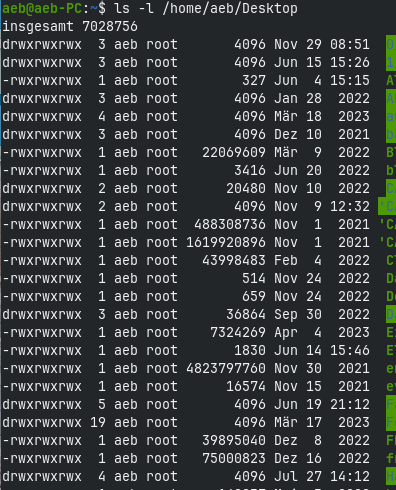

I'm not able to delete files or folders on the desktop - as long as I'm using the desktop itself.
Deleting the same files (in /home/aeb/Desktop) via any filemanager works perfectly fine.
I'm sure I have messed up some permissions, but where and how can I fix it?

As for your permissions, they seem off as normally you'd want to have only the minimum required. You can adjust them to something more appropriate with a few commands.
But before running them make sure that none of your files in the Desktop actually need to belong to a particular group, as this will change every file ownership to your current user (which normally is what you want, but just in case there's something special in your particular case).
And finally, remember that since there's root assigned the group you may need to prefix the first command with sudo.
chown -R $USER: $HOME/Desktop
find $HOME/Desktop -type f -exec chmod 640 {} \;
find $HOME/Desktop -type d -exec chmod 750 {} \;

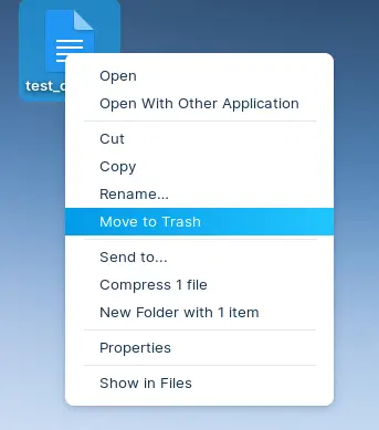

If I click on 'Move to Trash' nothing is happening.
Hitting the 'Del'-key also results in pure silence.
I can't even rename files. The dialog just won't close.
Strange enough I can create files (RMB -> New Document).

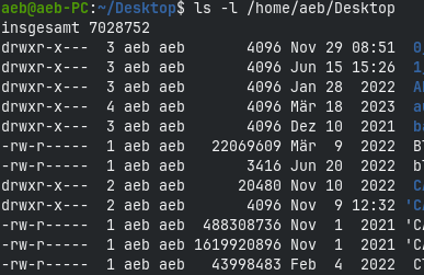

I tried your suggested commands. The permission are now as follows:
But the problem's not gone :frowning:

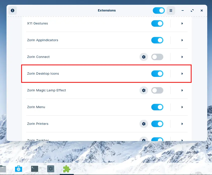

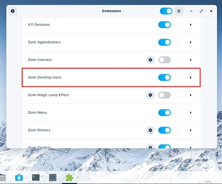

The fact that you can't interact with the menu makes me think it's something related to the desktop extension. Search for "Extensions" in the applications menu and look for "Zorin Desktop Icons"; toggle it off and wait a couple of seconds before turning it back on and try again.
