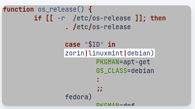

Double-click the downloaded driver file (e.g., amdgpu-install_..._all.deb).
then open a terminal and type
gnome-text-editor admin:///usr/bin/amdgpu-install
Replace any instance of "ubuntu" with "zorin" in the script.
