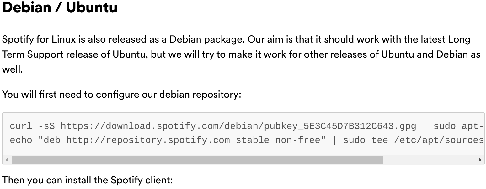

It sounds like the line curl -sS https://download.spotify.com/debian/pubkey_0D811D58.gpg | sudo apt-key add -
blended in with
echo "deb http://repository.spotify.com stable non-free" | sudo tee /etc/apt/sources.list.d/spotify.list
In other words, both separate commands were put into the terminal as one command. They must be separate:
To add the repo KEY, paste in:
Tap the enter key. Once done, add the repository:

That would be /etc/apt/sources.list.d/spotify.list
correct
@Aravisian I thank you very much for your kind and honest support. I now was able to run thru all of your commands and installed everything and the native spotify client. As far as I can see for now, no other errors popped up since then.
One little difference occured while copying the given commands from you: The pubkey you gave run into an error but I interchanged it with the one from the spotify page and then everything was fine.

Thanks for fixing that. I looked up the pubkey and must have gotten an outdated one.
