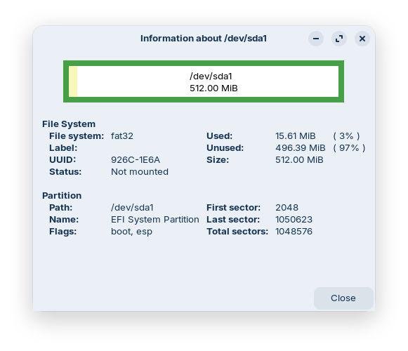

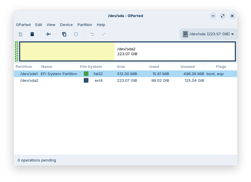

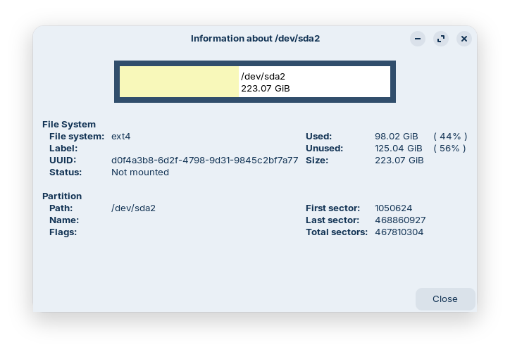

Hello! I'm new to the forum but I've been using Zorin for a little while, yesterday I tried installing a program to maybe have my capture card work on a windows virtual machine. I ended up messing with things I clearly shouldn't have and broke everything in the process.
I've looked around the internet and on multiple forums (including this one) for similar problems, and tried pretty much all possible solutions I've found.
I tried updating everything multiple times and I got different errors a couple times, I can probably list them if asked, but it would only be what I searched online, since I don't know how to replicate the situations themselves.
Right now I'm on a live USB, and I hope I don't have to reinstall the whole OS again ![]()
Onto the problem itself: If I try to boot up my computer, I only see a black screen with some text and >grub, it lets me type in commands and I can press tab for a list of commands. If I type in "exit" my PC tries to boot, but gets stuck on the Zorin logo.
I've tried going into recovery mode from the grub menu then used the repair option from there multiple times, it no longer downloads anything, as things seem to be fine from its point of view.
I've added the log from Boot Repair below as well.
