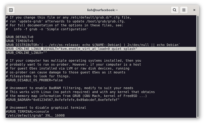

You can also follow this guide and add the parameter kvm.enable_virt_at_load=0
to file /etc/default/grub
Enter in terminal
sudo nano /etc/default/grub
Change the white marked line so that it looks like here (don't change other things in the file, the screenshot is not from Zorin):
(picture from gnulinux.ch)
Then press ctrl+o, then enter, then ctrl+x
Now run
sudo update-grub
and reboot
