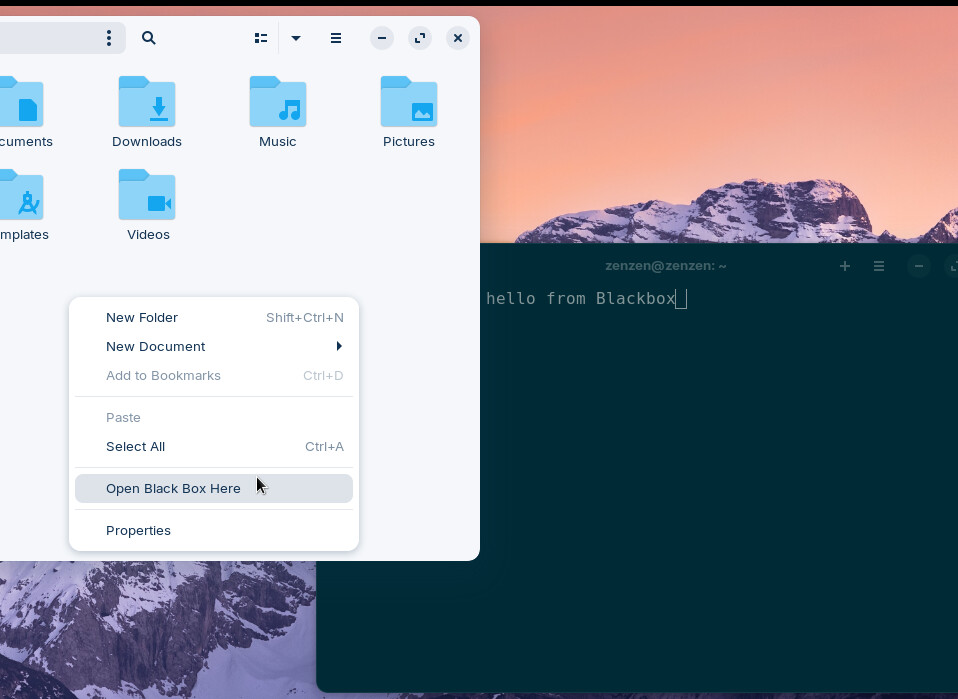

But is safe to ignore. Then, just apply the change with the newly available settings provided by this package:
gsettings set com.github.stunkymonkey.nautilus-open-any-terminal terminal blackbox
gsettings set com.github.stunkymonkey.nautilus-open-any-terminal keybindings '<Ctrl><Alt>t'
gsettings set com.github.stunkymonkey.nautilus-open-any-terminal new-tab true
gsettings set com.github.stunkymonkey.nautilus-open-any-terminal flatpak system
The trick is to not overcomplicate it :smiley:
Wow that seemed incredibly easy. It worked straight away with those commands. I used dconf-editor to change those keys, so i don't know where i went wrong. But it works now, thanks for your help =D
