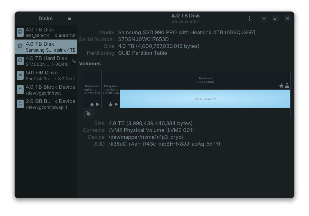

So, I honestly can't remember if I turned on ZFS for my system at my last full install, but I have the same single line in crypttab, for nvme1n1p3_crypt. If I look at nvme1 in GNOME Disks, I see this:
I'll admit to more familiarity with Bitlocker (or even TrueCrypt) than LUKS, but I've always read that arrangement as the logical, usable device living under the encrypted device in the same partition.
(The unencrypted stuff in the first two partitions are /boot/efi and /boot, which I gather are not ordinarily encrypted with LUKS encryption, and that it's possible, but significantly more complicated for very little gain. I'm not an encryption expert, and may be mistaken.)
