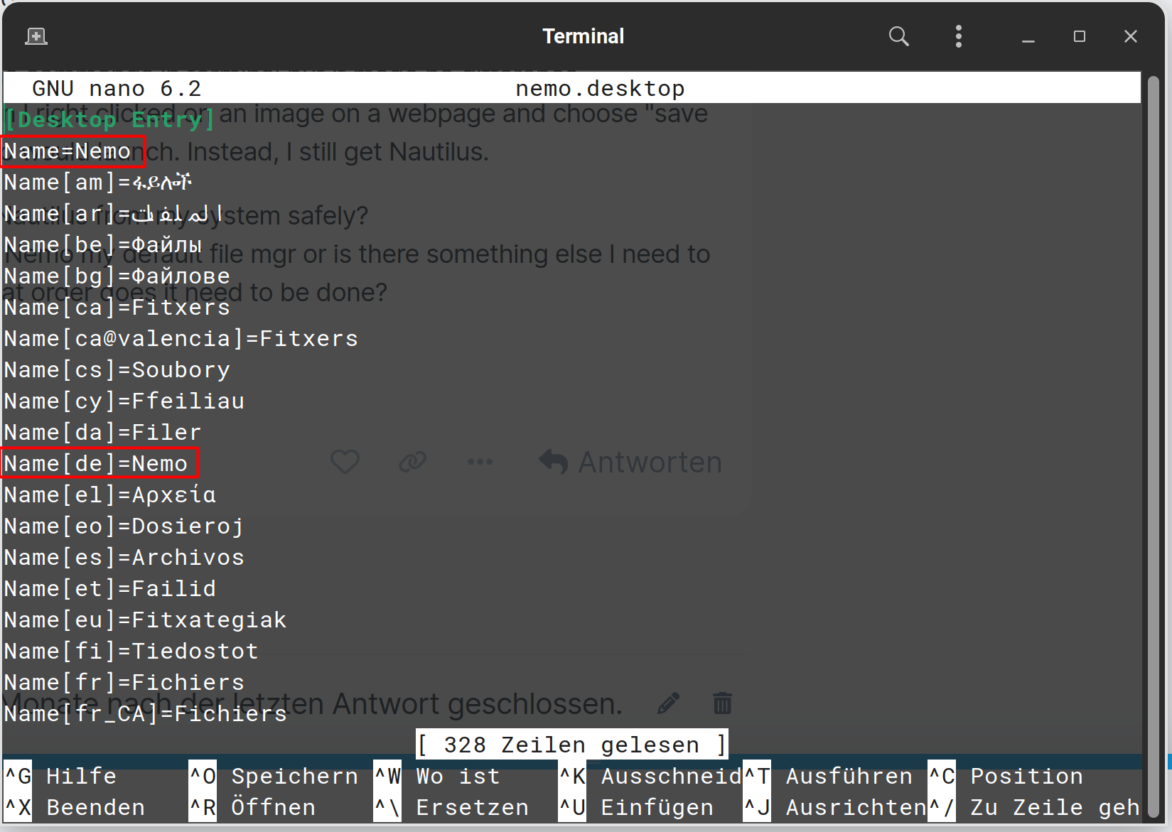

Here we must seperate 2 Things: Nautilus what You open with the Icon and what opens when you have picked a File. They look similar but these are two different Things. That is a Gnome Thing.
The same with the Names. But You can change the Name of Nemo to Nemo. Open the Terminal and type sudo nano /usr/share/applications/nemo.desktop and in the opening Window, You have to change the Name from Files to Nemo and on Your Language (in my Case german):

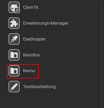

After that, press ctrl+o to save the Change, Enter to confirm and ctrl+x to exit. Don't forget that! After that You can close the Terminal. then You can see that it is changed to Nemo (maybe make a Reboot to affect):

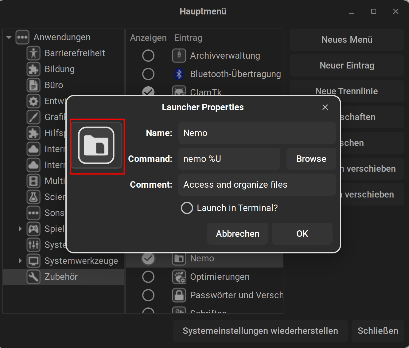

To change the Nemo Icon, open Main Menu, look for the Nemo Entry and then click on Properties and then You see a little Window. To change the Icon click on it and then pick an Icon that You want:

(That is about the only German that I remember from high school). I tried your solution and it worked. The icon is changed is for Nemo.
