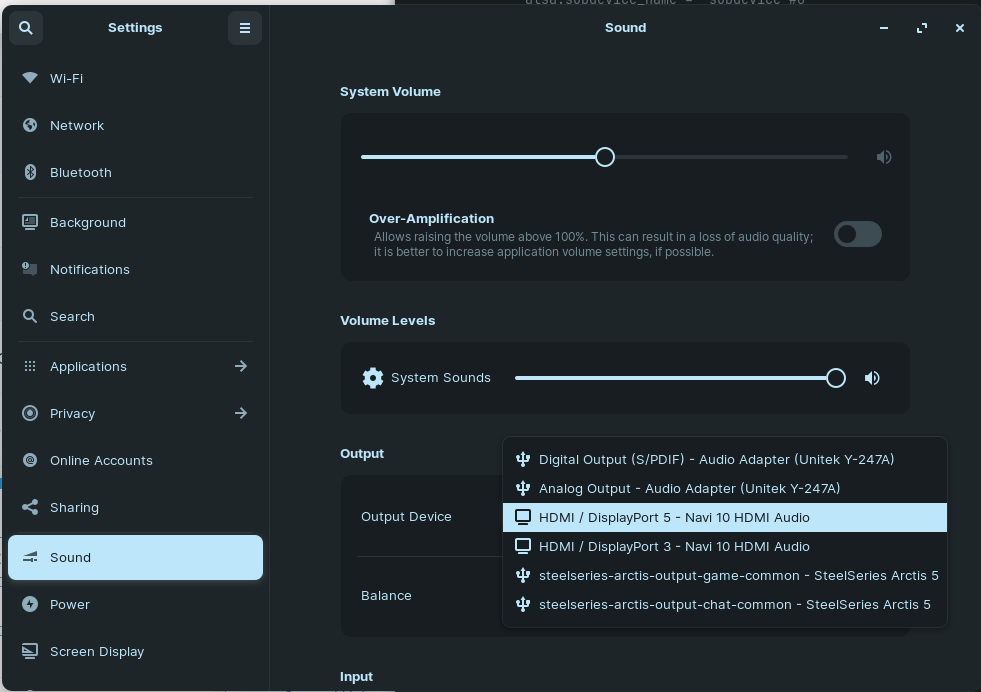

The issue I'm having is that when my secondary screen is turned on or off, my chosen audio output device changes to an unwanted one.
I'm running Zorin OS 16.2 Core on a system with an AMD RX 5700 GPU and two monitors - both with built in speakers. I also have a USB headset I use for gaming. The primary monitor turns on and off with the system and I use it as the speakers for my system when not using the headset. The secondary monitor does not automatically turn on, and is only turned on as needed. When the second monitor is turned on, the chosen output device changes. It originally changed to Analog output, but when i disabled analog output it now changes to my usb headset when the monitor is turned on.
From what I can determine the issue is that pactl does not distinguish between the primary monitor (HDMI 5) and the secondary monitor (HDMI 3), as shown below. Because HDMI 5 and HDMI 3 use the same output sink #25, when the second monitor is turned off or on the combined HDMI sink #25 is seen as temporarily removed and the output device is changed to the next currently available sink. Is there a way to set Zorin OS to remember chosen output devices, even if the chosen one is temporarily unavailable?
