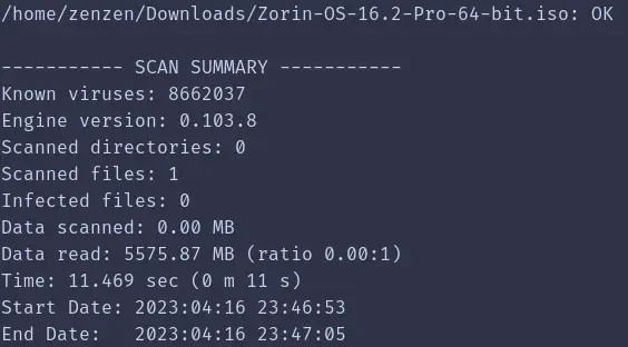

I've been using the ClamAV CLI for all sorts of files without issues. For example I'm able to run it against the ZorinOS 16.2 Pro iso (5.5GB) without any issues.
I'm wondering now if that is because of how this file type actually may be actually structured, into smaller chunks as Aravisian pointed out. However, I run it on every file I download regardless of the type or size, and it always seems to do it's job fine.
