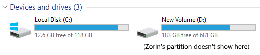

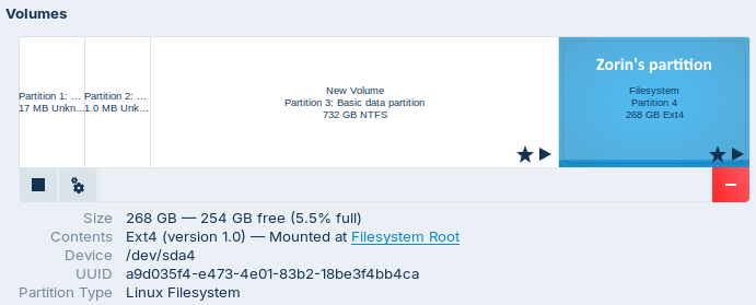

Hello! I've managed to set up dual booting on my PC with Windows 10 Pro and Zorin OS 18 Core. On startup, it works well, with the GRUB menu and everything. However, I installed Zorin OS on a partition of my HDD, and - I should've known - it's a bit slower than I thought it would be, hehe.
I'm aiming to reinstall Zorin 18 on a partition of my SSD after I clear up enough space on it to do so. However, through all the tumult of switching off Intel RST, combing through other posts and Ubuntu guides, getting the GRUB menu to function, etc., I'm worried about losing hours of work and redoing everything (including the settings and basic apps/packages I've already set up on Zorin.)

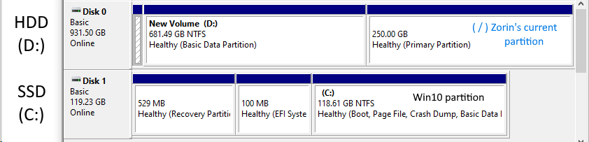

- 1TB HDD / ~750GB part., ~250GB part.
So, is there some easy way to transfer Zorin and all its basic stuff to a new partition on my SSD? Would it be relatively safe to do, even?

In trying this, even after arranging my partitions to be the same size, Rescuezilla wouldn't let me pass to clone (I forget what the error was specifically). So, I eventually decided to flash its older brother Clonezilla to a drive instead. I guess I waded through firmware anyway, hehe...
And, it worked! Clonezilla's options took care of GRUB and the bootloader, and I still haven't encountered any issues. I hope Rescuezilla works for someone else with the same case, anyhow.
