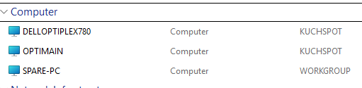

I'm making progress. Today for the first time I saw my Zorin box on Network Neighborhood on Win11. BUT even though I set the workgroup in the smb.conf, it still shows as WORKGROUP on Win11, which is not the name of my workgroup. Therefore, I cannot access the Z-box.
Any suggestions besides the smb.conf that I might need to change the workgroup?

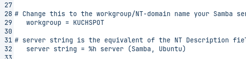

From recollection it should just be the smb.conf (/etc/samba/smb.conf) and then as you said, change workgroup = to yours (KUCHSPOT). Then save the file, and reboot the samba service :
sudo systemctl restart smbd
If you look in your smb.conf file, did it save the contents correctly after restarting the service? Sometimes something as simple as it not saving could possibly cause that. Could also post a shot of the config just to make sure of that as well.
Here's that line from smb.conf. Looks right to me.
I've restarted the samba service and also rebooted since then... also have rebooted Win11.

I'm thinking more and more it's on the Windows side. I just opened my Win10Pro pc. On it's network, it can both see and access my Zorin box, no trouble at all.
(but it doesn't see the VM Mint; though Mint sees and accesses Win10)
Win10 also shows it is on a different workgroup than Zorin, which I'm beginning to think the workgroup is NOT the issue.

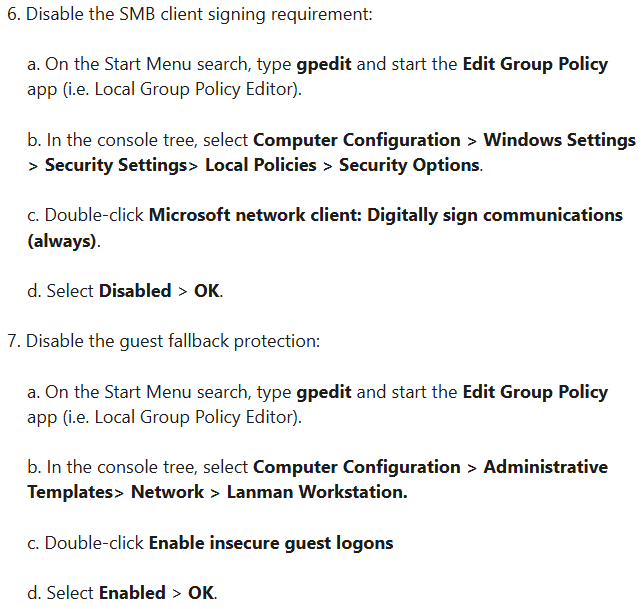

Take a look here about forcing SMB3:
I successfully can see Zorin from Win11Pro.
On Accessing third-party NAS with SMB in Windows 11 24H2 may fail | Windows 11 Forum
I believe these 2 steps changed my ability to access Zorin:
Because I have used Windows for so long, and Linux is strange to me, I initially assumed it must be the fault of the "Unknown." But then, Win11 is pretty unknown, too, and so much is hidden out of sight from users. Crazy stuff.
I will consider this SOLVED.
