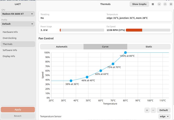

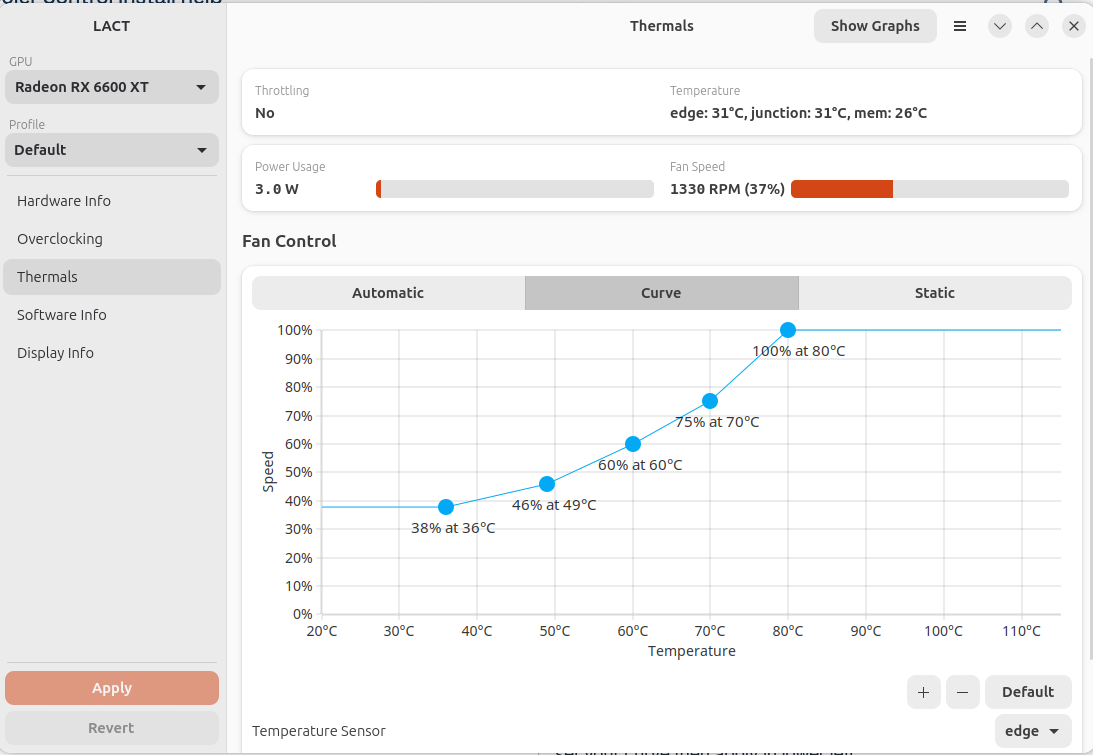

With LACT you just enable the overclock not that you will use that then thermels then curve set your curve then apply in lower left

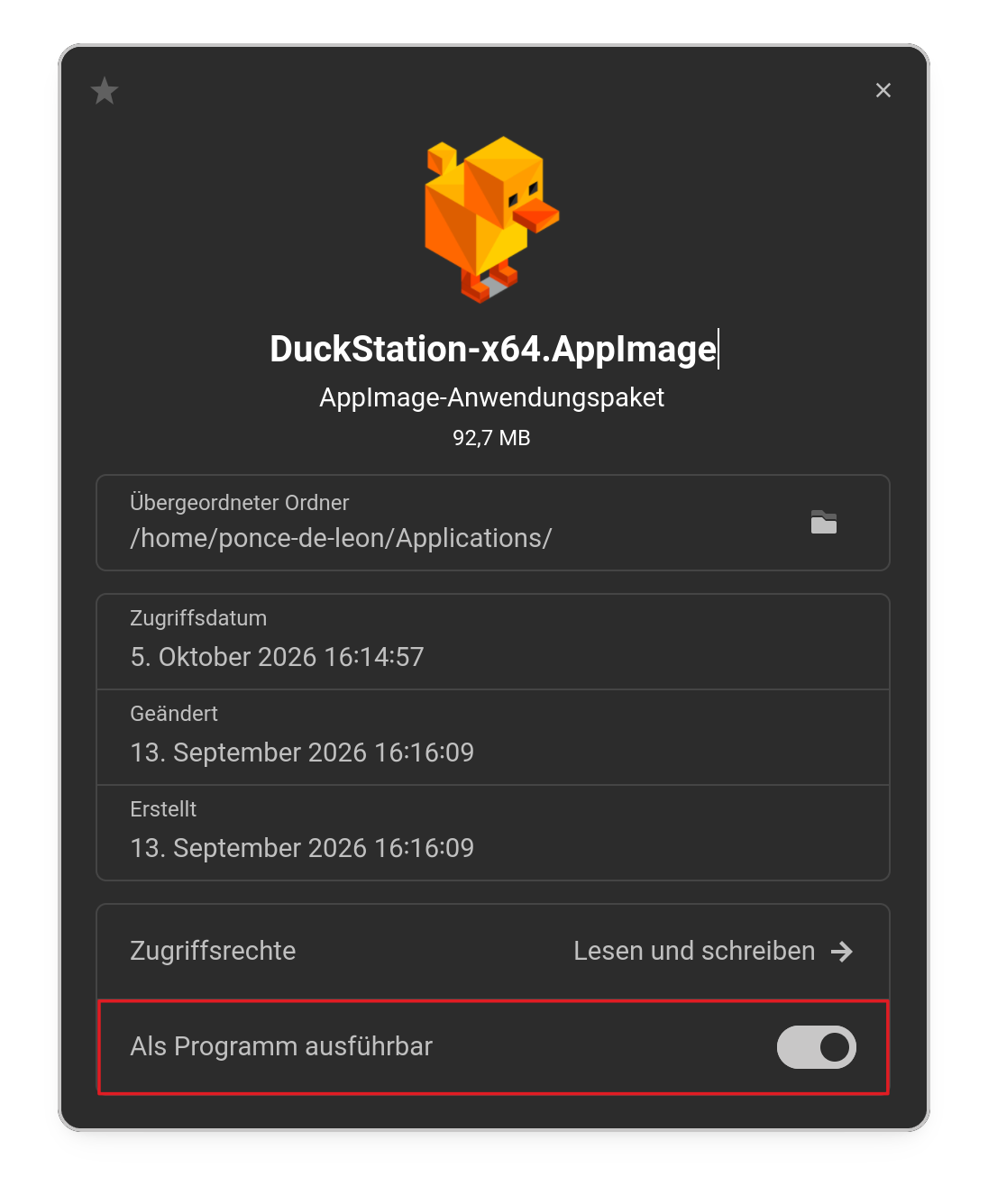

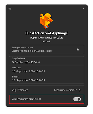

You can make on the AppImage a Right-Click and select Properties. Scroll there down and activate the Toggle ''Run as executive''.
