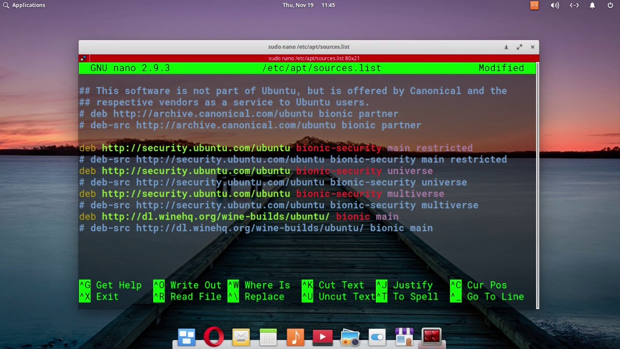

Since it's already broken you could go ahead and try to fix this manually, but whatever you do first of all make a copy of that file first:
# Any name will do, for example
sudo cp /etc/apt/sources.list /etc/apt/sources.old.list
My guess is that is probably missing some "main" at the end of one of the line or something. If you don't mind sharing the file we could take a look here. Otherwise you can try educating yourself with a video such as this one:

[Edit...] I renamed sources.list here and then ran sudo apt update and sudo apt-get update which both now seem to work. Interestingly, it didn't recreate etc/apt/sources.list but it did create a new sources.list in rofs/etc/apt. The new version is a plain text file containing the following text:-
deb http://archive.ubuntu.com/ubuntu/ bionic main restricted universe multiverse
# deb-src http://archive.ubuntu.com/ubuntu/ bionic main restricted universe multiverse
deb http://archive.ubuntu.com/ubuntu/ bionic-updates main restricted universe multiverse
# deb-src http://archive.ubuntu.com/ubuntu/ bionic-updates main restricted universe multiverse
deb http://archive.ubuntu.com/ubuntu/ bionic-security main restricted universe multiverse
# deb-src http://archive.ubuntu.com/ubuntu/ bionic-security main restricted universe multiverse
deb http://archive.ubuntu.com/ubuntu/ bionic-backports main restricted universe multiverse
# deb-src http://archive.ubuntu.com/ubuntu/ bionic-backports main restricted universe multiverse
Some progress at least, that's more like what is should look like. The article mentioned by @swarfendor437 looks like it could solve the issue altogether, give it a read specially the "Solution 6 - /etc/apt/sources.list is missing or corrupted" section, and see if that works.
