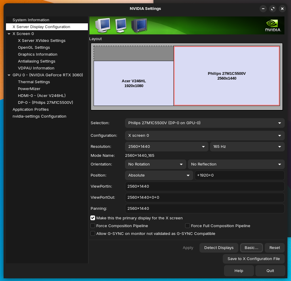

EDIT: If you just want it to work you can use the nvidia server settings app to set it manually.
As an Addition to that: xrandr only works in X11/Xorg and not with Wayland.
Thank you so much for your answer, I hope this will resolve it. Regarding the nvidia software, would it work with amd gpu?
If you have an amd gpu, you'll have to go for the xrandr solution
