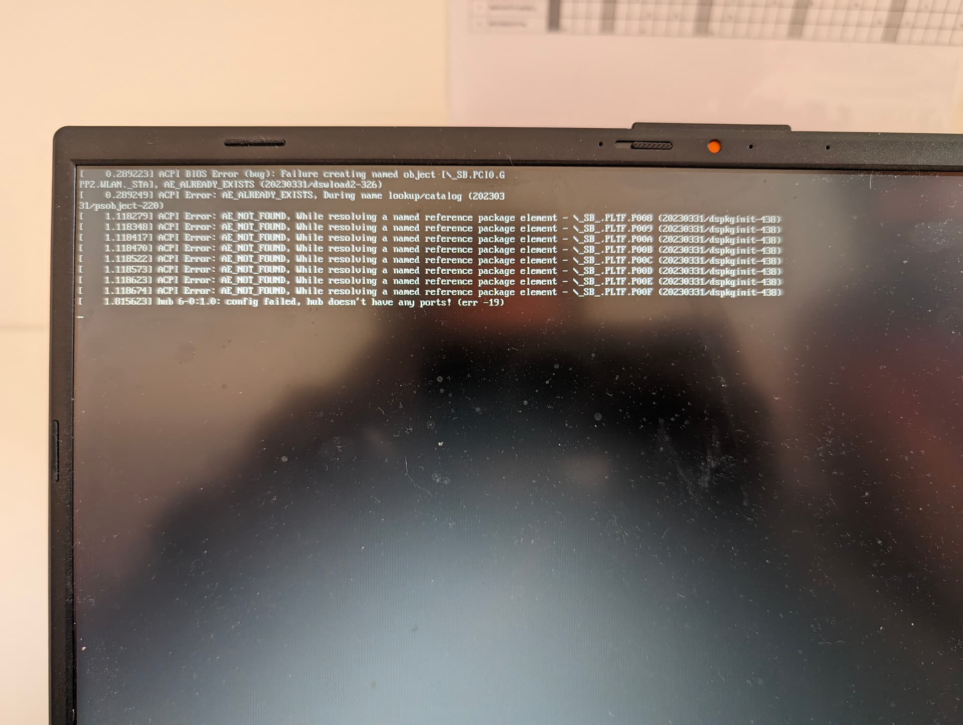

Ho disinstallato zorin, scaricato zorin pro e controllato il checksum ed è corretto, installato e niente solito problema, noto che in fase di avvio mi da delle stringhe di codice
Translation:
I uninstalled zorin, downloaded zorin pro and checked the checksum and it's correct, installed and nothing usual problem, I notice that at startup it gives me some strings of code
Re: ACPI errors. See this: ACPI errors on boot - #2 by swarfendor437
By "usual problem" do you mean cursor freezing and screen goes black?
Maybe you need to use a more recent linux kernel.
PS. It would help and save us time if you provided an English translation of your posts using an online translator, which I have been having to do on your behalf.
Sorry for the translation but I wasn't thinking about it, I followed the post and the error messages at startup are resolved, now I'm retesting the system to see if it crashes, I'll let you know how it goes, for now thank you very much
