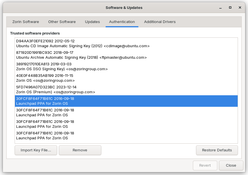

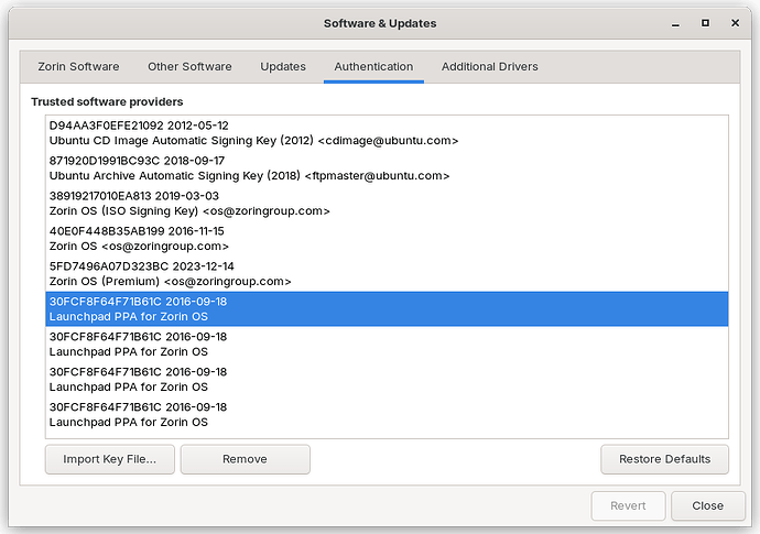

Oups,
@zenzen
I discovered this, the pad is mentioned several times?!
In Software & Udates > Authentification
Is it normal?
What do you recommend me?
Restore?
Remove?
Thank you for your feedback :slight_smile:
José
Launchpad is a platform that the Zorin developers use to share their code for the project. It has no connection to the actual physical trackpad on a laptop, so that's completely normal :smiley:
