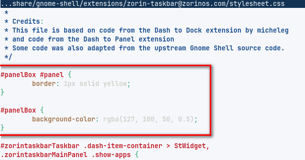

You have to define the thickness of the border, the style (I think only solid is allowed) and the color, which can be in hexadecimal or RGB notation, as well as plain names for simple colors like "blue".
For the panel color, you can use something like:
#panelBox {
        background-color: rgba(127, 100, 50, 0.5);
Again, you can define the color in any notation as mentioned above. The "A" in RGBA stands for alpha which is the opacity, expressed as a number between 0 (completely transparent) and 1 (completely opaque).
Just as a reminder, the files inside the extension folder might be overwritten during an update, so you might want to keep a copy or notes somewhere else.

I have tried this but I think I have done something wrong :thinking:
The border-color works.
But not the panel-color. It is still in the Zorin-blue.
Here is my code:
What did I wrong?

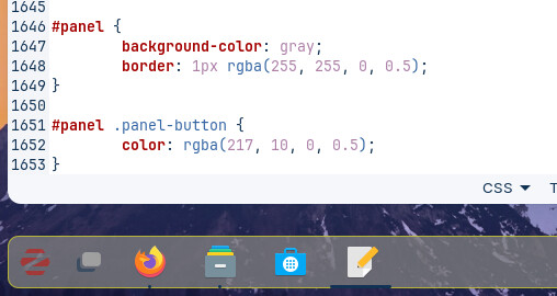

Hi!
@Ponce-De-Leon and @zenzen: I just wanted to know you, that I found a solution. And it was quite easy. You have to add these lines to the gnome-shell.css. Then it works :smiley:
Maybe it helps other people if they want to change the colors.
And a big thank you to all of you which helped me! :smile:
Did You add it to the gnome-shell.css from the Zorin Theme?
Yes, I added it to the gnome-shell.css of the Zorin-Light-Blue-Theme.
