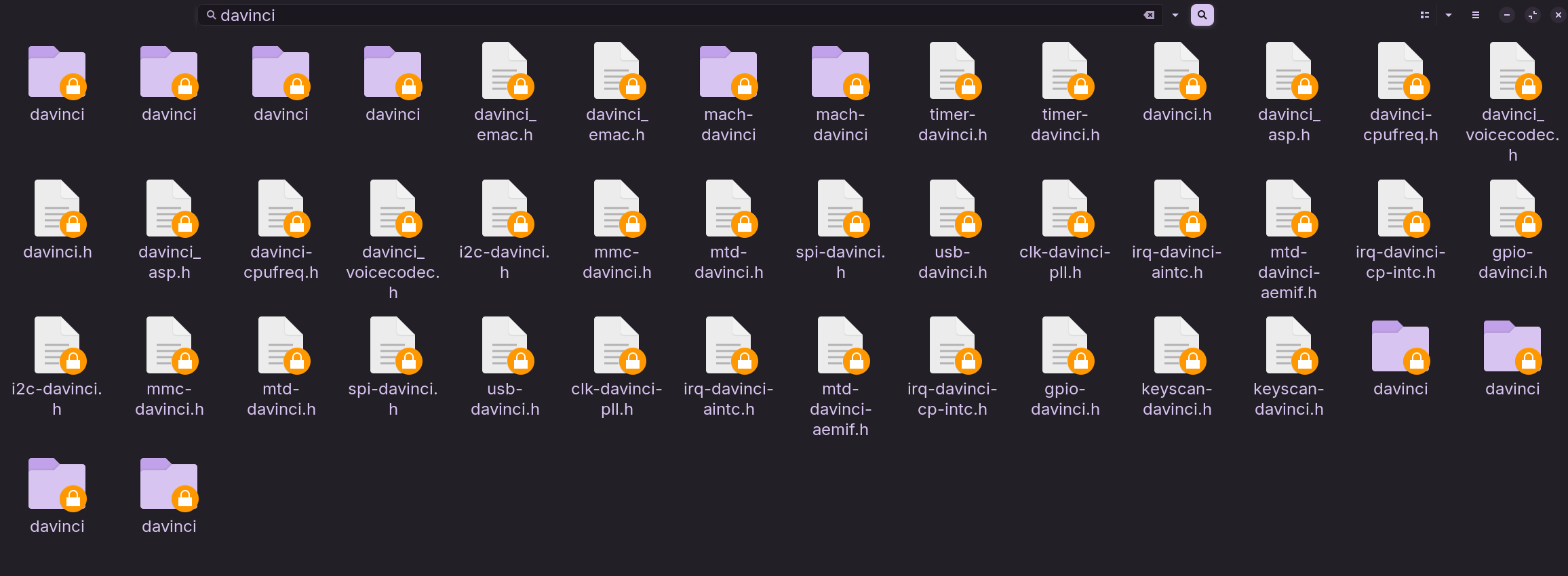

I will try to do that to clean up the files the best I can then. Are there any tricks for knowing what files are good to delete? I see a lot of files with DaVinci in the name in the folder "usr/src/linux-hwe-6.8-headers-6.8.0-59/". Are these the configuration files you were talking about?
Wow.
Weird.
No.
Do not remove anything from /usr/src - that is the System Kernel.
I am... confused. I cannot fathom that BlackMagic would add any software specific files to the Linux Kernel folder.
I have never installed DaVinci... I may need to in order to see if there is a coincidence in a name being used. I have never ever come across anything like this before...
Wow, that was not what I was expecting. I'm glad I didn't mess with them then. I checked and I have a total of 10 folders and 34 other files with davinci in the name in that directory. All of the files are under a few different subdirectories in that first directory I mentioned. I hope they didn't hack into my computer or anything. I know with "free" software the user's data is normally the "payment."
No, I do not think it is illicit or a hacking.
Far more likely that we hit the lottery on Coincidental nameing.

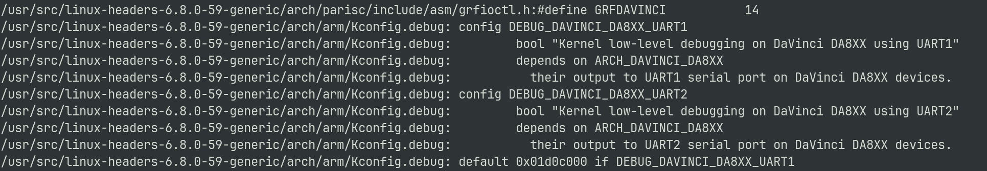

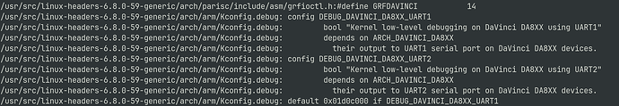

Can you please show us the files?
grep -Ri 'DaVinci' /usr/src/ | head
That is a relief :slight_smile:
Here is the output from your command:
And for reference this is what I was looking at in the GUI after searching davinci:
That helped - referencing this module support, it is Texas Instruments TI DaVinci DA8xx - this is some ARM based hardware that has Linux Kernel support - Confirmed that it is a name coincidence.
