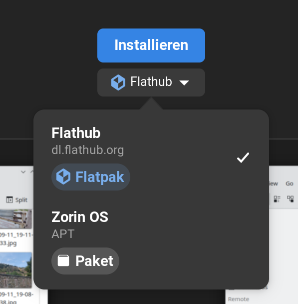

Do You have installed Dolphin as Flatpak or APT? Because Flatpaks have limited Permissions the theming would have to set up. When You would use the APT Package, this wouldn't be neccessary because it is the native Package Format.
Open Gnome Software, search for ''Dolphin'' and look at the Software Page what Format is installed:
As an Alternative, You could try Nemo as File Manager. It is a nice one, too. You can install it in Gnome Software or in the Terminal with the Command sudo apt install nemo
I installed the APT version so I'm not sure what permissions it has missing. Going to try Nemo to see if it's any better.
