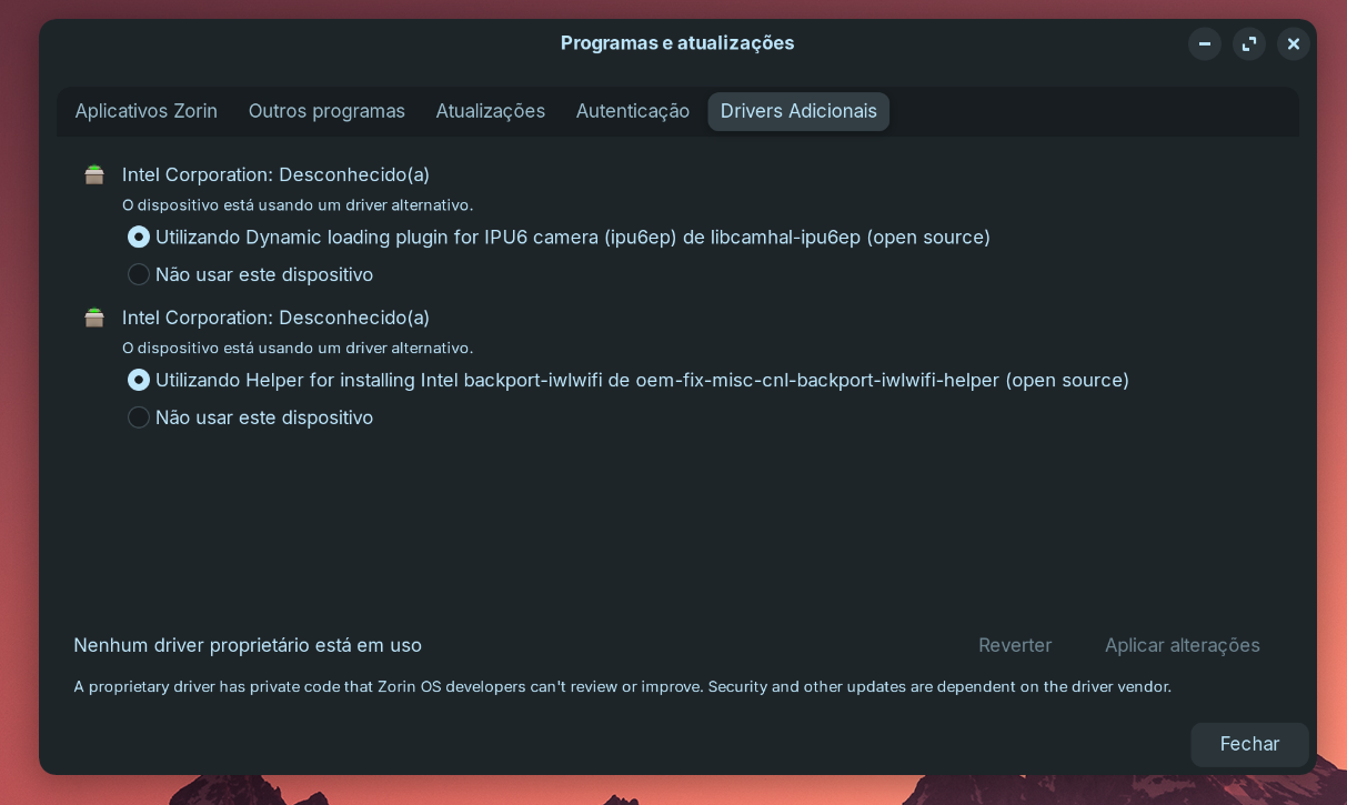

I think that is really related to the kernel:
i just tried the Ubuntu 25.04 live and is not working either.
i know is not hardware fault cause i do have a dual boot with windows 11 on this laptop.
