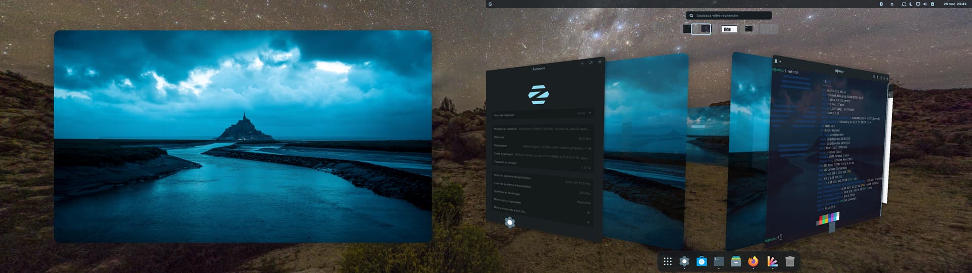

My desktop cube show only desktops active on the laptop screen and the monitor at the left side seems not to be part of any desktop. I was expecting each side of the cube to show left screen+right screen . The background panorama is shown on both monitors but the left monitor part of the desktop is not in the cube.

Here is an example of how the cube looks :+1:
The cube effect is only on the right desktop (my laptop screen) but does not rotate the left screen (external monitor).
