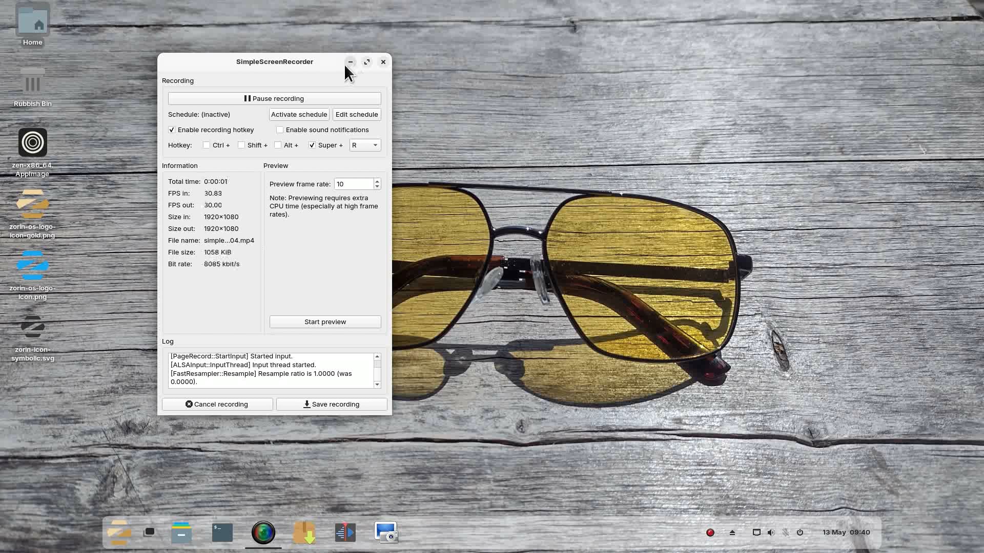

I just noticed this but the issue only persists if I swipe to switch from one workspace to another. Setting fixed number of workspaces also doesn't help.

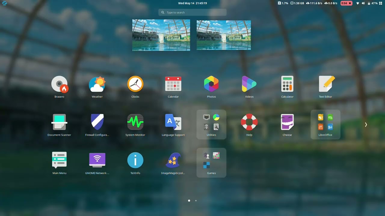

I see from you screenshot you only have 2 workspaces. What happens when you change to four? That is what mine got set to when I chose 'Fixed number of workspaces'.
Same thing is happening.
Just looked at your screencast. I suspect it might be something to do with the Gnome desktop theme. Don't have this issue with the Windows 7 theme.
