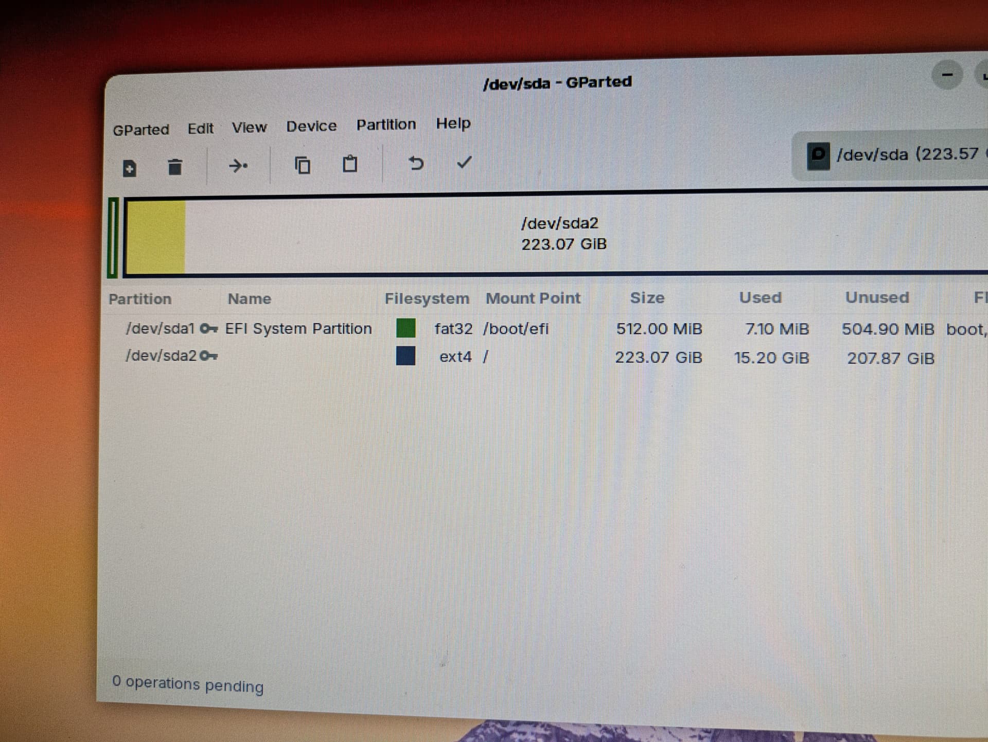

Did the same thing again. First, this is how my SSD drive looks with a fresh Zorin installation

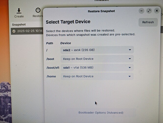

Now, when I go to restore the backup, Time shift says the partitions that the files were backed up from have been preselected, but the first option is blank and it doesnt work.
Looking at the options, I select the sda drive
and run Restore and this takes ages and, once this is completed, the computer will not boot. Have done this twice.

I notice that there is a key icon in your GParted screenshot - is it an encrypted drive?
It's not intended to be

It's strange there is the previous screenshot showing the two partitions on the SSD drive, but this is the warning message before restoring

The key icon in GParted indicates the partition is in use and can't be worked with at the time, given a quick search. / will always be mounted. I imagine /boot stays mounted, but I don't know for certain. In order to work with them in GParted, they'd need to boot from a live USB, so the partitions to be handled aren't mounted.

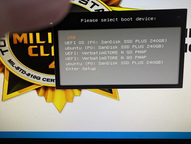

Just also wanting to make sure; In your Boot Menu, when selecting either Ubuntu boot option after you've restored the files, do either of them work? None of them? Do they give you errors of some description?
That first screenshot is when the computer was working after a fresh install, so no problem at that time. The problems start when I run Time shift to restore my backup
I don't get to a boot menu. All I get is a Zorin icon and the name Zorin. But now I get nothing at all whatever I do

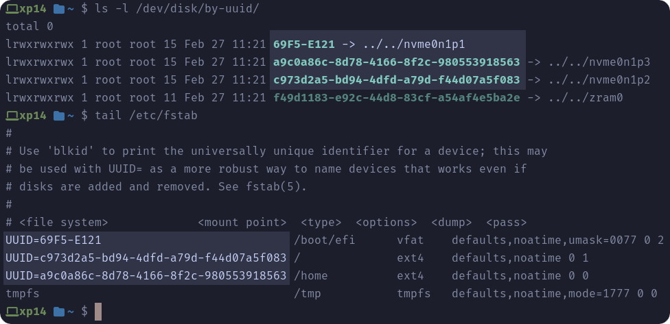

Again, I'm not familiar with how Timeshift works and how it would handle situations like this, but it makes sense from the description of this issue that the culprit is with the UUID of the newly formatted partitions. Assuming this indeed the problem, you can try a hacky workaround that problem by manually editing the system configuration files that describe the mount points at boot...
First, try running these commands in the terminal to see what the current state it:
ls -l /dev/disk/by-uuid
tail /etc/fstab
You should get something like the screenshot below:
But I suspect that in your case there will be a mismatch between each output.
