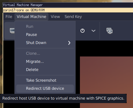

But, if the drive is detected fine even by other programs then it must be specific to those emulators. Are you sure there are no options to explicitly make them available? For example, for virtual machines you must make that choice explicitly otherwise external drives are not detected (at least with software like Virtual Manager):

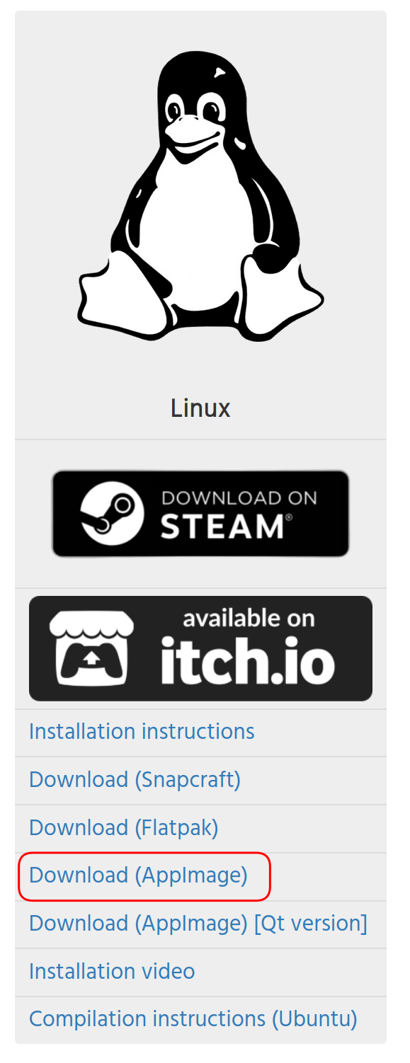

Then, I would suggest to go to the Download Page:
And there download the AppImage and try that:
They also offer an Installation Video on Youtube (AppImage is the last Part of it):
Thank you for your help but I have already tried it. That link is a Steam download and i don't want it on my pc. However the problem is also with other programs, i tried also a Super Nes emulator. Pheraps the solution is the kind of label on Disks (for example "Label=Data") but now i cannot try it.
The black Button goes to Steam, yes. But I marked with a red Frame the AppImage under it.
